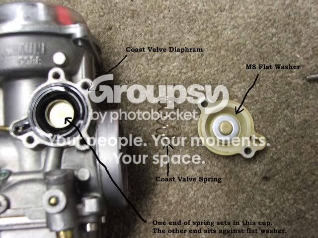

This is what a coaster enricher valve looks like:
https://i87.photobucket.com/albums/k154/HDI_IA/CoastValveShimming.jpg
Popping on the overrun on a CG125 is almost certainly an air leak somewhere. I will repeat, almost always in the exhaust system.
