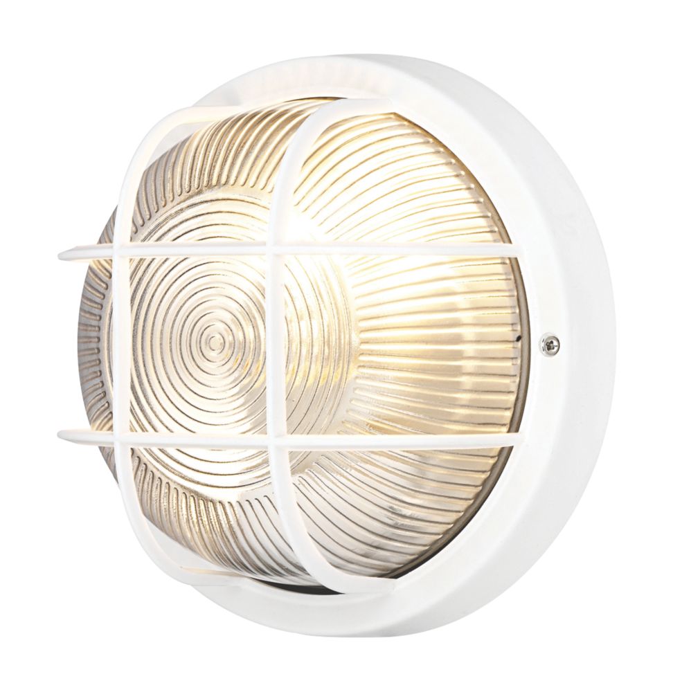

Have you considered a bulkhead light? Something like this (or the oval variants)
https://s7g3.scene7.com/is/image//ae235?src=ae235/18998_P&$prodImageMedium$
The advantage in a loft is that you tend to have limited headroom so you avoid breaking the bulb by either nutting it or bashing it with something you are putting up there. They will let the cable come in from the side, too.

Bamt
I have considered that yes,
The ones I have attached are 3 quid each, thought I could put four up there dotted around,
They take 60W lamps, I need enough light to be able to see books/dvds that are kept up there,
Never used them, they give off much light?
Does the plastic cover hinder the light output?
I did see they can be wired from the side so relatively easy to go in and out,

bamt
Joined: 15 Dec 2013
PostPosted: 19:25 - 08 Jul 2016    Post subject: Reply with quote
The actual ones I use were cheap from B&Q (or similar), taking standard light bulbs - with 60W ones fitted IIRC. The plastic grill thing doesn't cover enough to cast a shadow or hinder light output.
It was more about having something robust, having stuck my head into a bare light bulb in the past.
Crap output tbh. Plus if you bang your head on that you'll know about it Laughing

Im-a-Ridah wrote:
I don't know about that particular one, it was the first similar picture I found. Two of the more rectangular ones with 60W bulbs in work fine. I've broken enough exposed light bulbs in tight spaces (also knocking them moving long things around, not just hitting them myself) to not want that risk again - especially if it somewhere where being plunged into darkness isn't safe. I'd rather bang my head on something a bit hard than bang my head on something hot and fragile that then breaks, showers me in glass and means I can't see either. Similarly I'd never put a bare fluorescent tube in that kind of location - good light, but way too easy to break.
