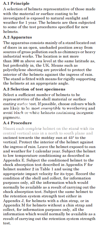

Rogerborg wrote:
It's your claim, you get to show the working.
In order to appease the pedants, helmets are tested for 1 year, use beyond that is outside the scope of the testing.
Excerpt from BS6658-1985
https://img.photobucket.com/albums/v284/geoffhill/Capture_zpsmayvmlre.png

Northern Monkey wrote:
We'll just be back for more. Drooling
~4380 hours of daylight.
Incidentally, ECE 22.05 specifies "ultraviolet irradiation by a 125-watt xenon-filled quartz lamp for 48 hours at a range of 25 cm". Your guess is as good as mine what that means in the real world.
They could be tested in Scotland. They might only get 4.380 hours of sunlight in a given year
