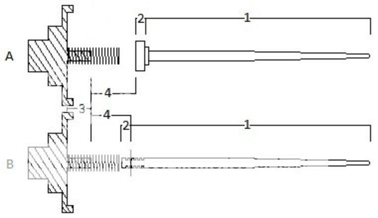

https://i666.photobucket.com/albums/vv23/WiNot_Rhencullen/Workshop/Needle_zpsx50ualln.jpg

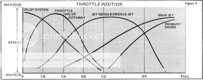

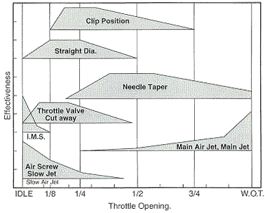

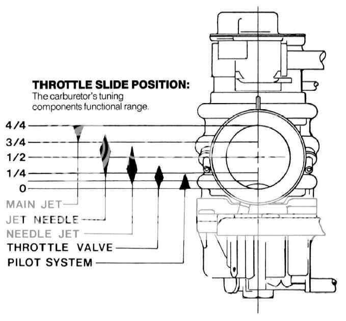

The instructions that came with the kit suggested that the pilot jets can be left as standard,but that a hole needed to be enlarged in the CV carb slide so as to change how this lifts when that circuit was enabled.looking at the diagram you can see which component comes into play at a given throttle opening.What it does not show is that on a CV carb the slides do not start to open until around 5-6,000 rpm,so up to those engine revs it is mainly the air screw,float height and pilot jets.
https://i666.photobucket.com/albums/vv23/WiNot_Rhencullen/Workshop/calchart_zpsqw9waci5.gif

https://i666.photobucket.com/albums/vv23/WiNot_Rhencullen/Workshop/jettingeffects_zpsfppa7sat.jpg
