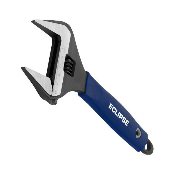

PostPosted: 16:51 - 24 Sep 2015    Post subject: Reply with quote
Vincent wrote:
Another tool I've only just noticed......although they've probably been about ages....... are extra wide jaws, slim, adjustable spanners
Now that would be handy. I have a small adjustable spanner in the toolkit under the seat but one with wider jaws is more useful.
This kind of thing?
