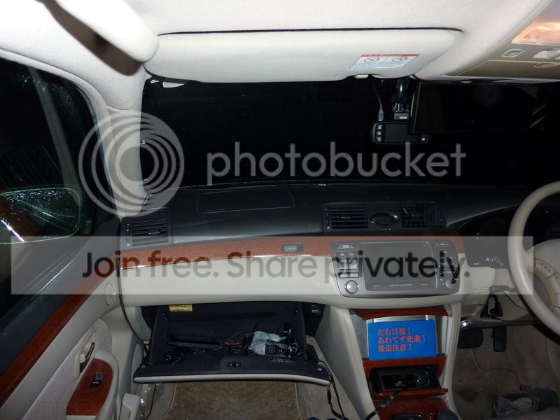

Thanks for your input stinkwheel.
I bought an expensive power adaptor additionally from the seller of DOD which suggested me, but it didn't work so well than I expected.
Now USB power adaptor is plugged into the extended cigarette lighter socket in the glove box. There are 5 power adaptors in the glove box now(for dashcam front/rear, radar detector, portable navi, and smart phone charger). I think I need to improve this. I'm not electronically minded at all, I will ask mechanic if some of them can be wired in the method you suggested.
((only the DOD adapter jams radio among five))
https://i21.photobucket.com/albums/b295/kawashima_/wiring_zpsehkoz4ub.jpg
