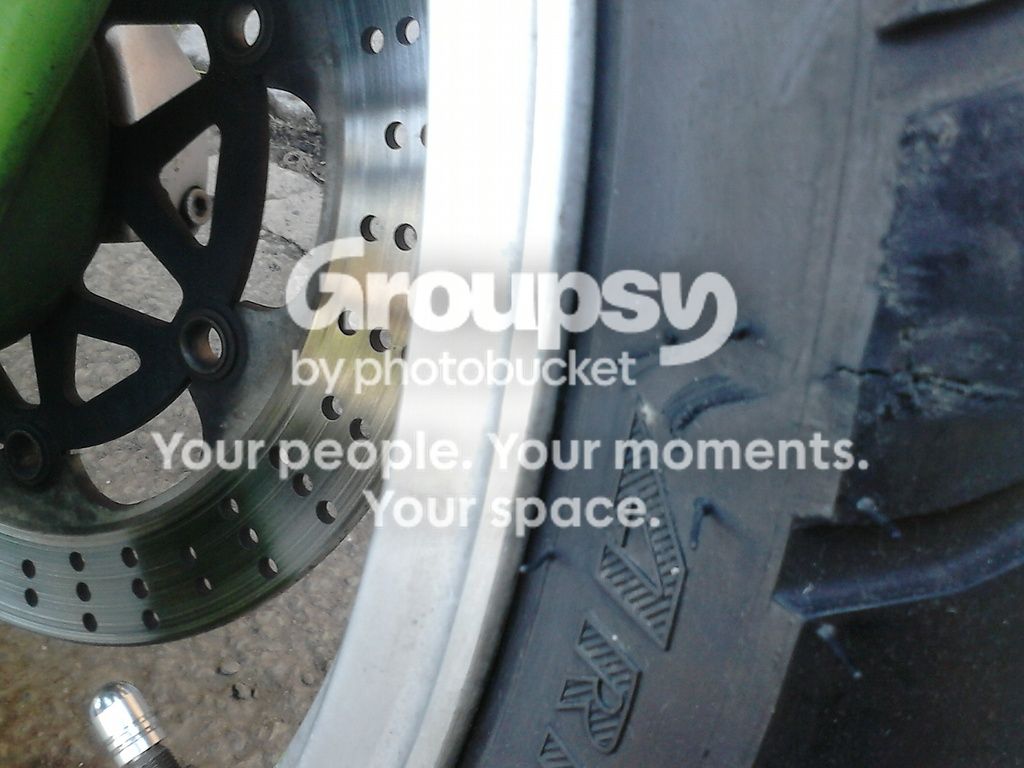

Here's what I've managed, after running over a brick at 80kph, I was just overtaking a lorry, so when I saw it I had no time to react, I managed to avoid direct impact but couldn't completely avoid it. I consider this to be still alright to ride.
https://i970.photobucket.com/albums/ae184/RhynoCZ/ZX7R/DSC_2534_zpss4fwggow.jpg

RhynoCZ wrote:
OP, that is beyond repair. You can even see the foreign object cut through the sidewall's kevlar fibers. Also, the tyre in your picture looks very old, I mean all the cracks in the rubber. Thumbs Down
The problem with tyre damage is that it is impossible to open the tyre up to look inside. So based on history of tyre failures the recommended action is replace. Even that tyre is a fail. Unless you just want to run it off road. Sad
