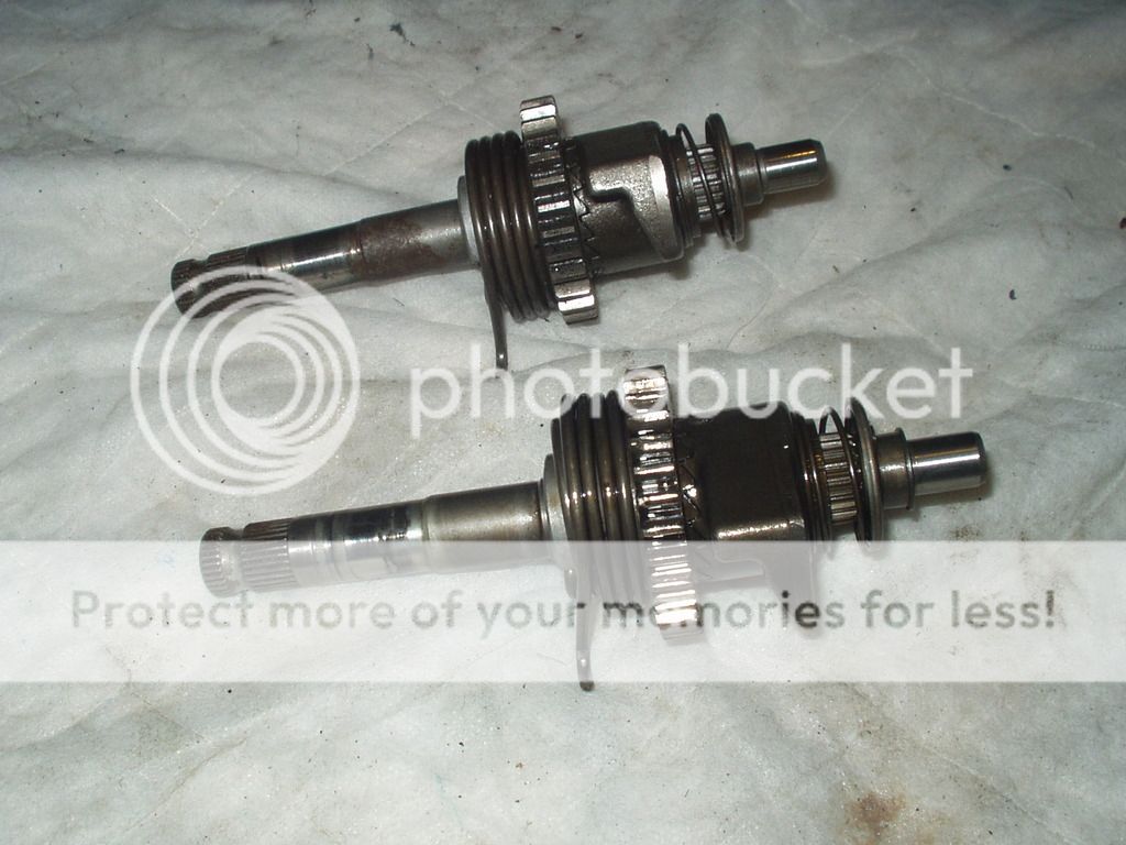

According to the "Haynes" the first thing that needs to go in is the kickstart mechanism.
I've got two to choose from, I'll be picking the best parts from both to, hopefully, make one good one.
https://i645.photobucket.com/albums/uu172/Troodos-Pool-Guy/Eng%20Rbld/001%20Kick_zpsacqdyyug.jpg
At first glance they seem to be in, roughly, the same condition.
However a closer inspection reveals that the teeth on one of the starter pinnions are quite badly damaged, so that will be heading for the scrap heap.
https://i645.photobucket.com/albums/uu172/Troodos-Pool-Guy/Eng%20Rbld/002%20Kick_zpsfyqblb94.jpg
Now they're apart a few things show up, the lower of the two, in the photo, is in the worst condition, as well as the pinnion teeth having bits missing, the spring on the rachet mechanism seems to have lost some of its "spring", it's shorter than the other one.
Also the return spring is showing signs of wear, there is a kink forming where it locates into the shaft.
I'll be using the top one in the photo.
According to the manual the tolerances that need to be checked are the ID of the pinnion wheel and the OD of the shaft where the pinnion runs.
The shaft is not worn at all, the pinnion is slightly out but well within the tolerance allowed.
The only thing I have to be careful about when reassembling this is lining up some punch marks, one on the ratchet and the other on the shaft.  These punch marks are very small and also quite difficult to line up, basically, because they're not on the same plane, (Old farts like me may need a magnifying glass).
