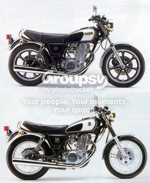

Also cast looks better than spoke imo.
https://i21.photobucket.com/albums/b295/kawashima_/sr400_zpsipapcwie.jpg

On a bike like the SR you posted, spokes are pretty much just for show.
On a serious off road bike they tend to cope with abuse better than cast wheels, and minor damage is easily repairable (for instance changing a broken spoke) compared to a cracked or dented cast wheel.
Spoked wheels rot quite badly in my experience if they're not looked after. Cast wheels are more a fit and forget type of thing. It was quite common to change the standard spoked wheels on the TDR 250 for cast items from the TZR for this reason (excuse the teenage me):
