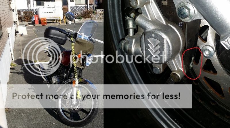

I forgot about disc lock and started, I found a minor damage on front brake, and when I apply front brake, I hear scratching noise of brake pad and disc. And I need to pull the lever more now(more free play of the lever). I didn't find brake fluid dripping.
What kind of damage do you think this is?
I think I will bring my bike to the shop next weekend.

I've done that a few times over the years, on a few different bikes Sad
Most likely to have warped the disc slightly, although that looks to be a steel caliper bracket so there's a small chance you've nudged the caliper and brake disk out of alignment.

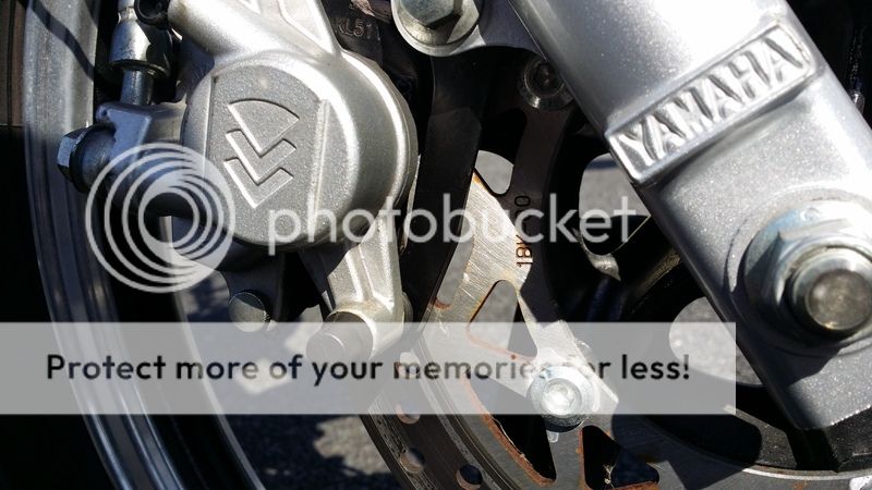

I received my bike on Feb 11th. (It took 12 days)
Damage was caliper support only.
This is Chinese import and I was worrying it might take long to order parts from China, but luckily it came faster. (Or maybe importer had stock parts)
I asked them change brake fluid too, cause mine was 2012 model which I bought as new in 2014 winter.
Now front brake feels much better and can control with two fingers.
I clearly noticed the difference of fluid between 4year old one and new one. Under 250cc doesn't have MOT here and it's not mandatory, but I was hearing this bike has weird brake fluid as new(because made in China), so I wanted to change it.
