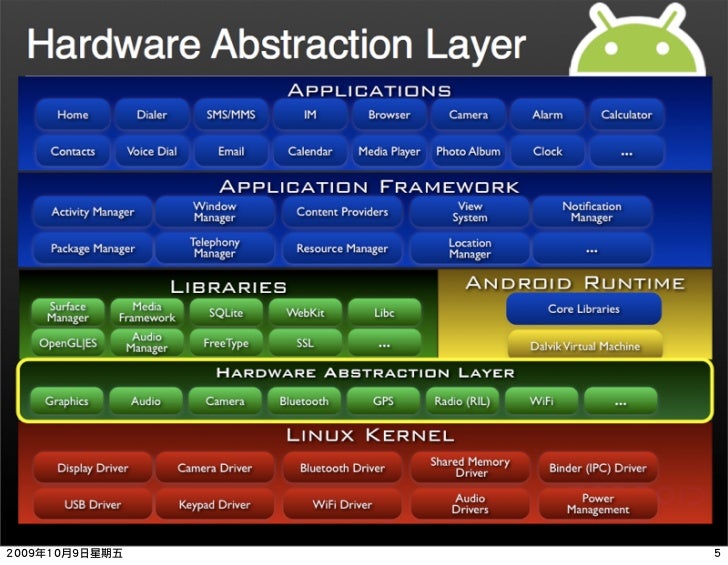

Take a look at this image:
https://image.slidesharecdn.com/android-os-driver-hal-r2-091009031110-phpapp01/95/android-hal-introduction-libhardware-and-its-legacy-5-728.jpg?cb=1255057901[/img]
Android provides a "Hardware Abstraction Layer" (HAL). This is basically a really simple messaging format. Everything that sits on top of HAL is completely agnostic to the device that it is running on. It could be a super computer. It could be a car. It could be a phone. It could be a tablet.
HAL basically defines a whole bunch of interfaces, telling the Linux Kernel what operations must be available. For example HAL could specify that the WiFi driver must be able to respond to a request for "find WiFi networks". This is great because the Android system can then just talk to HAL and say "find me the WiFi networks".
And this is where the difficulty for installing an OS on to different hardware comes in. In order to operate, the person who built your phone needed to create drivers for the Linux Kernel and add them to their version of the Android build. The drivers are specific to the device.
If you wanted to install Android on an iPhone for example, the software would work all as expected, but the drivers would simply not exist. You would have to make them from scratch, which is very challenging and time consuming. However perhaps some of the hardware components in the iPhone are used on a HTC (calm down, just a fictitious example), so you can steal the driver from the HTC for that component, lessening your work load.
I don't know for certain, but I would imagine that Windows and iOS do the same process. So the easy answer to your question is;
It's technically possible, but good luck finding the drivers that you'll need.
