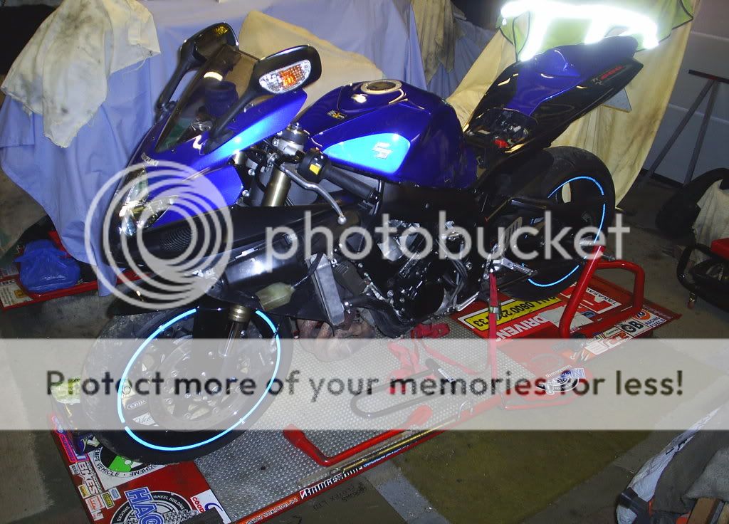

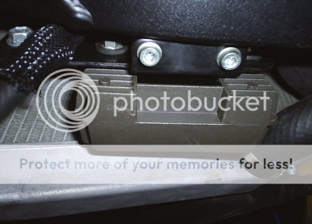

Where the r/r is located is not the best of places for heat dissipation and of the two GSXR600K6s that I have seen cooking the units,both replacements were pattern parts and far better at isolating the r/r from the radiated heat from the frame down tube.
This one has a large heat sink that goes between the frame and the r/r
https://electrexworld.co.uk/acatalog/RR852.html
This one has far larger fins on the r/r
https://i666.photobucket.com/albums/vv23/WiNot_Rhencullen/Workshop/032.jpg
https://i666.photobucket.com/albums/vv23/WiNot_Rhencullen/Workshop/028.jpg
This one came from the USA and was more expensive than the one from electrexworld.
But neither bikes have had any further problems Thumbs Up
