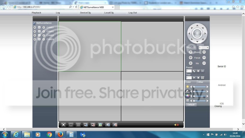

First off all the set up can only be done when the DVR is connected direct to a TV or monitor.
When connected via the network you have to use IE and it will require downloading an ActiveX widgit, without that it won't work. Once downloaded and restarted you should be able to see the output from your cameras, something like this...
https://i945.photobucket.com/albums/ad297/750RK/Odds%20and%20ends/cctv2.jpg
In network mode you can only do things like playback or magnify an individual cameras view.
There are no passwords except those that you put on it or the distributor did if they are being annoying. All units have the user name of Admin until changed by you.
Assuming you haven't changed the HTTP port you should be able to connect over the network but you will either bneed to set a static IP on the unit or a reserved IP on the router. If you change the HTTP port to 443 or 8080 as I had to do for external access then you may need to tag these on the end of the IP eg :443 :8080 to get full access.
