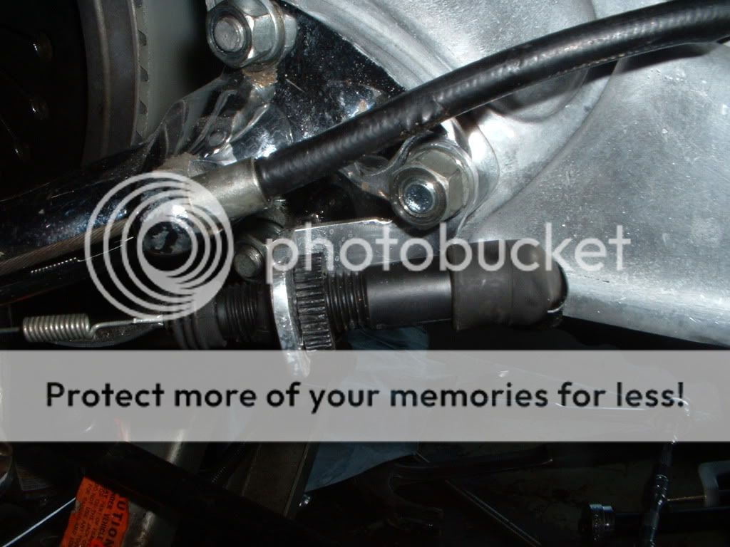

The rear brake light switch, no it is not normal. But I wouldn't do much about it at the moment, just use it more often, and it'll start to work properly. The previous owner was not using the rear brake, so the switch got stiff. You may adjust it though.
The FRONT BRAKE SWITCH: Yes, it does click (only one click when you engage the brake), but you shouldn't be able to hear it with the engine on really, but it is possible.
The REAR BRAKE SWITCH ADJUSTMENT: There's something like this (see picture below), as you can see you may move the switch in order to adjust when the light comes on. You could spray it with contact cleaner, as dirt is obviously not letting the rod of the switch to work properly. When you step on the brake pedal, you pull the wire with spring on it, that engages the switch.
