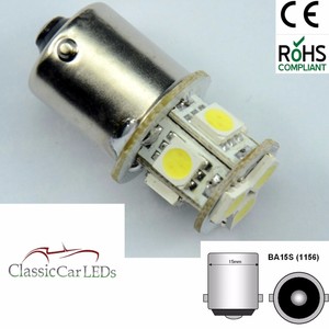

I just got some LED indicator bulbs for the wifes bike which have surface mount LEDs on, they are super-bright. Almost too bright as they're close to overwhelming the orange tint on the indicator lenses and just appearing white.
https://i.ebayimg.com/00/s/MTYwMFgxNjAw/z/-zkAAOSwBLlVHYHP/$_35.JPG
