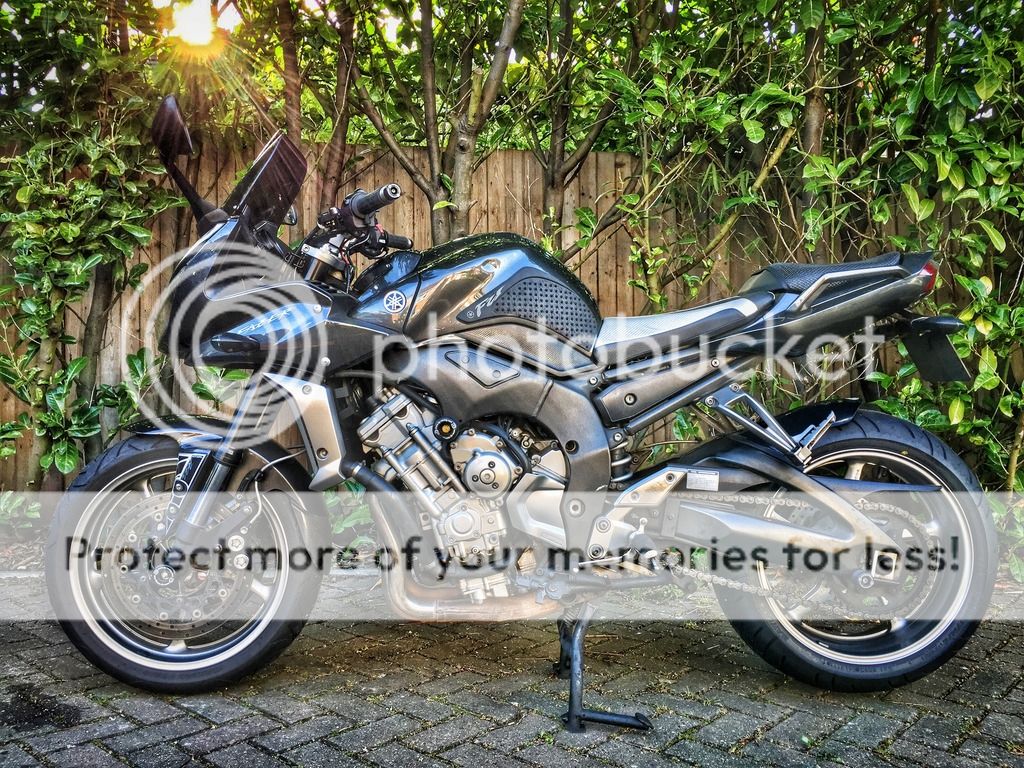

Agreed. Fairing is good.
https://i2.photobucket.com/albums/y41/doovydoo/18D2C7C0-3E3E-44DB-803D-A49A719EC186_zpslkiouqf4.jpg
Just FYI, I paid £3.2k for mine (2008 model, with 17k miles) last August.
