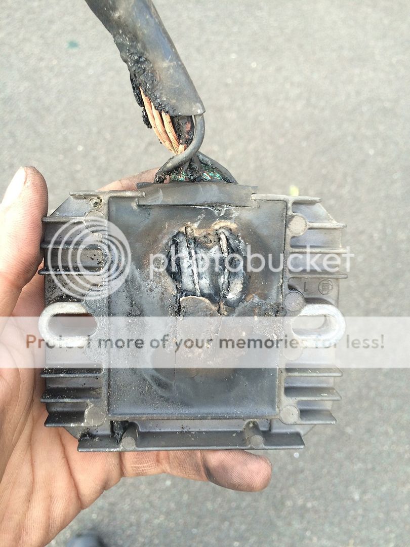

PostPosted: 13:05 - 03 Jun 2016    Post subject: Reply with quote
It's a common issue on the K6/7 600/750's. They over heat because they're badly positioned. I believe the K8 onwards GSXR's we're recalled for their rectifiers.
If you have FB, join the GSXR Owners UK page, post there and you'll get a lot of suggestions of what to do and photos of where and how people have repositioned there's. I believe a common one is using a tax discs to reposition it to the side of the bike (so it sits flush with your side fairing).
He's how my brothers one looked on his K6 750, it actually went into a small flame.
https://i789.photobucket.com/albums/yy178/AzAndBikes/E1D919B1-9202-4442-8C7F-46593463121C_zpsjqobg2rh.jpg
I replaced the above for my brother and it's easy to do tbf.
Tank up, airbox off, then it's just a matter of unplugging and unbolting the rectifier.
