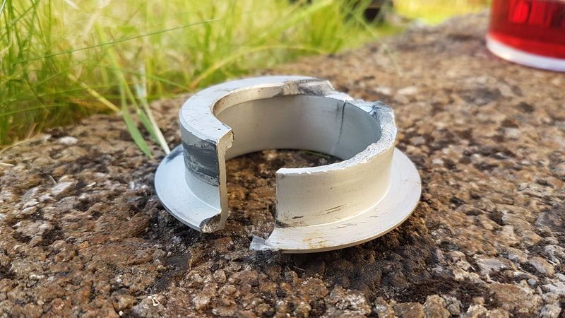

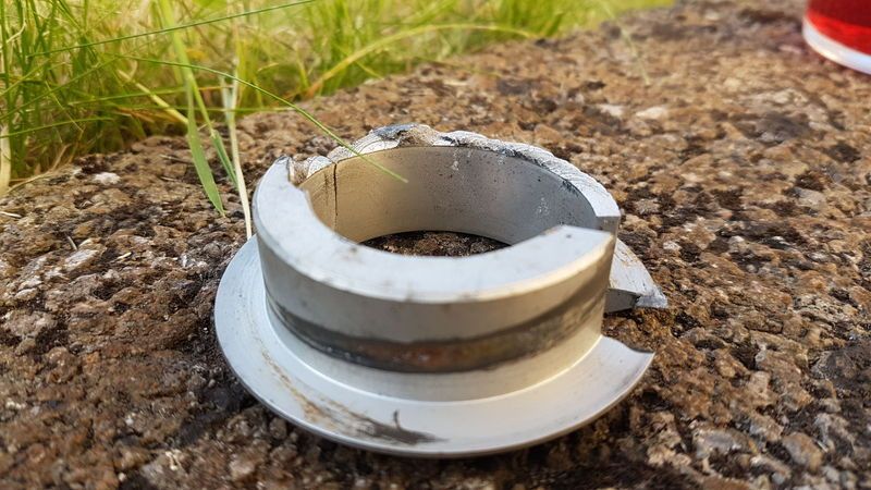

Step 1: The first realisation that the collar had fallen out of the top of the spring without the need for spring compressors and that it was looking a little, well... mangled.
https://img.photobucket.com/albums/v357/Inkersall/Bike%20Stuff/Bike%20Shock/IMG-20160603-WA0038_zpsutdhywps.jpeg
https://img.photobucket.com/albums/v357/Inkersall/Bike%20Stuff/Bike%20Shock/IMG-20160603-WA0040_zpsbb9weue0.jpeg
Yep, that's a crack. A crack that goes almost all the way to the top.

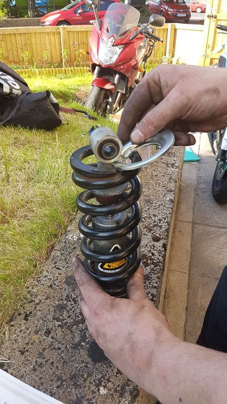

But wait, there's more.
https://img.photobucket.com/albums/v357/Inkersall/Bike%20Stuff/Bike%20Shock/IMG-20160603-WA0042_zpsine3dnfp.jpeg
https://img.photobucket.com/albums/v357/Inkersall/Bike%20Stuff/Bike%20Shock/IMG-20160603-WA0044_zpswtfoknfo.jpeg
Where the *insert expletive of choice* is the rest?!?
So, we put the old shock back together, because Fretgrinder noticed something... well, just plain odd.
10pts to whoever notices the first bit that's more than a little wrong in this picture...

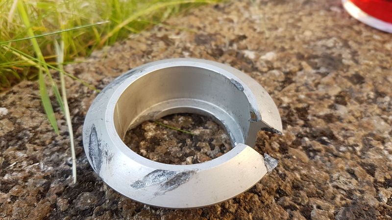

Because my original collar sure as hell seems to fit nicely and snugly right about... here...
https://img.photobucket.com/albums/v357/Inkersall/Bike%20Stuff/Bike%20Shock/IMG-20160603-WA0067_zps1wklqwqs.jpeg

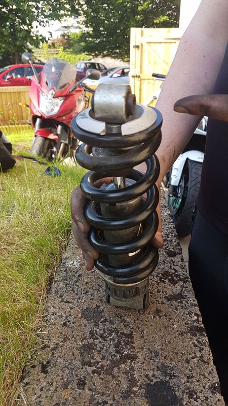

But how strange, it's certainly not going to fit nice and conveniently on this little bump stop when the completely relaxed spring is in the way!
https://img.photobucket.com/albums/v357/Inkersall/Bike%20Stuff/Bike%20Shock/IMG-20160603-WA0069_zpsfzwyoi4c.jpeg
So there we have it, boys and girls, a tale of horrendous modification that still has me tempted to take the garage responsible to court, if it wasn't for the fact that the garage is conveniently no longer trading under its old name and has revamped itself with a different family member. Even though this so-called self-proclaimed 'suspension guru' confirmed that yep, this is how they lower their bikes. With crack pot collar mods that pop out and on the wrong bump, could have caused some serious damage.

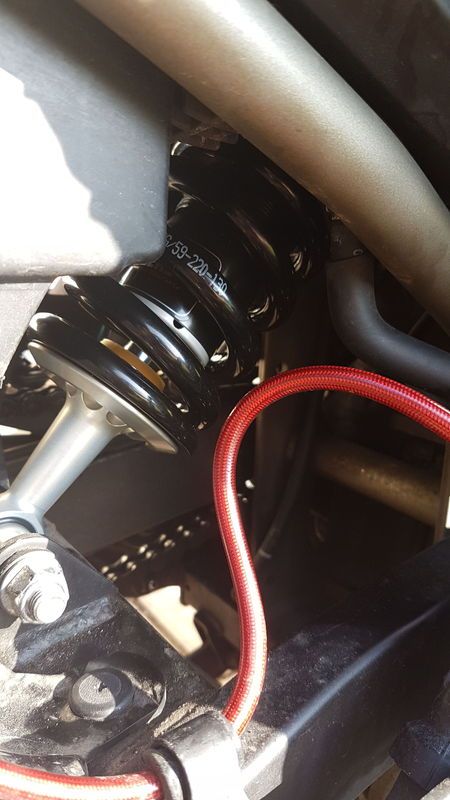

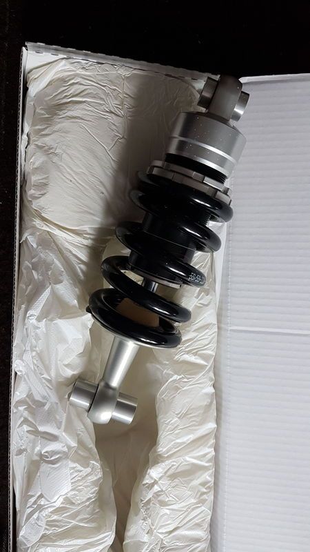

But in case you're wondering, the much improved shock that will no doubt save the day, looks awesome.

That is truly shocking work, if you pardon the pun. You should at least name and shame the place that did it, so that others can be warned to keep away.
The marks on the top of the collar suggest that it's been rubbing on the top shock mount. Might want to check that area for damage or at least missing paint.
