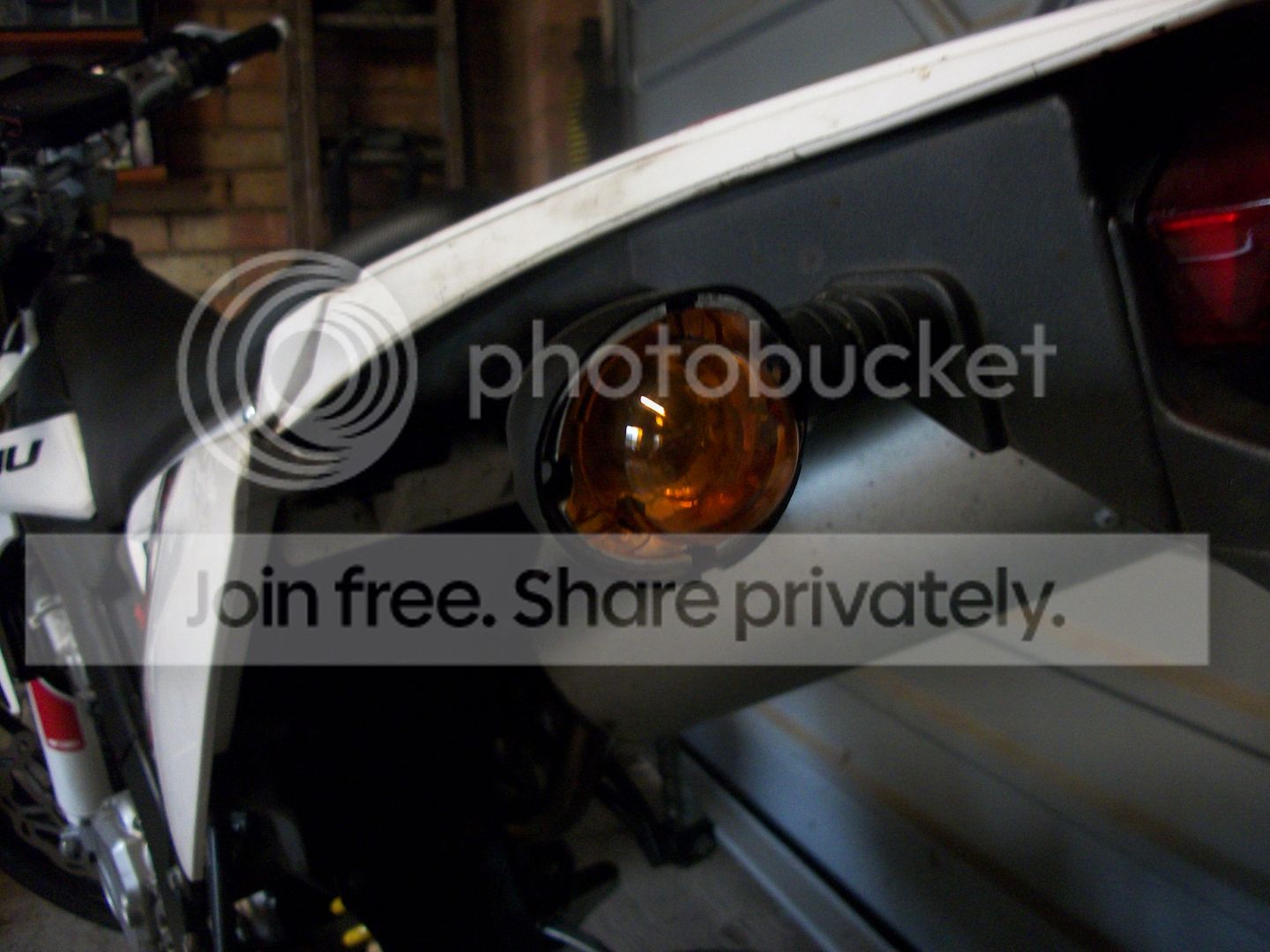

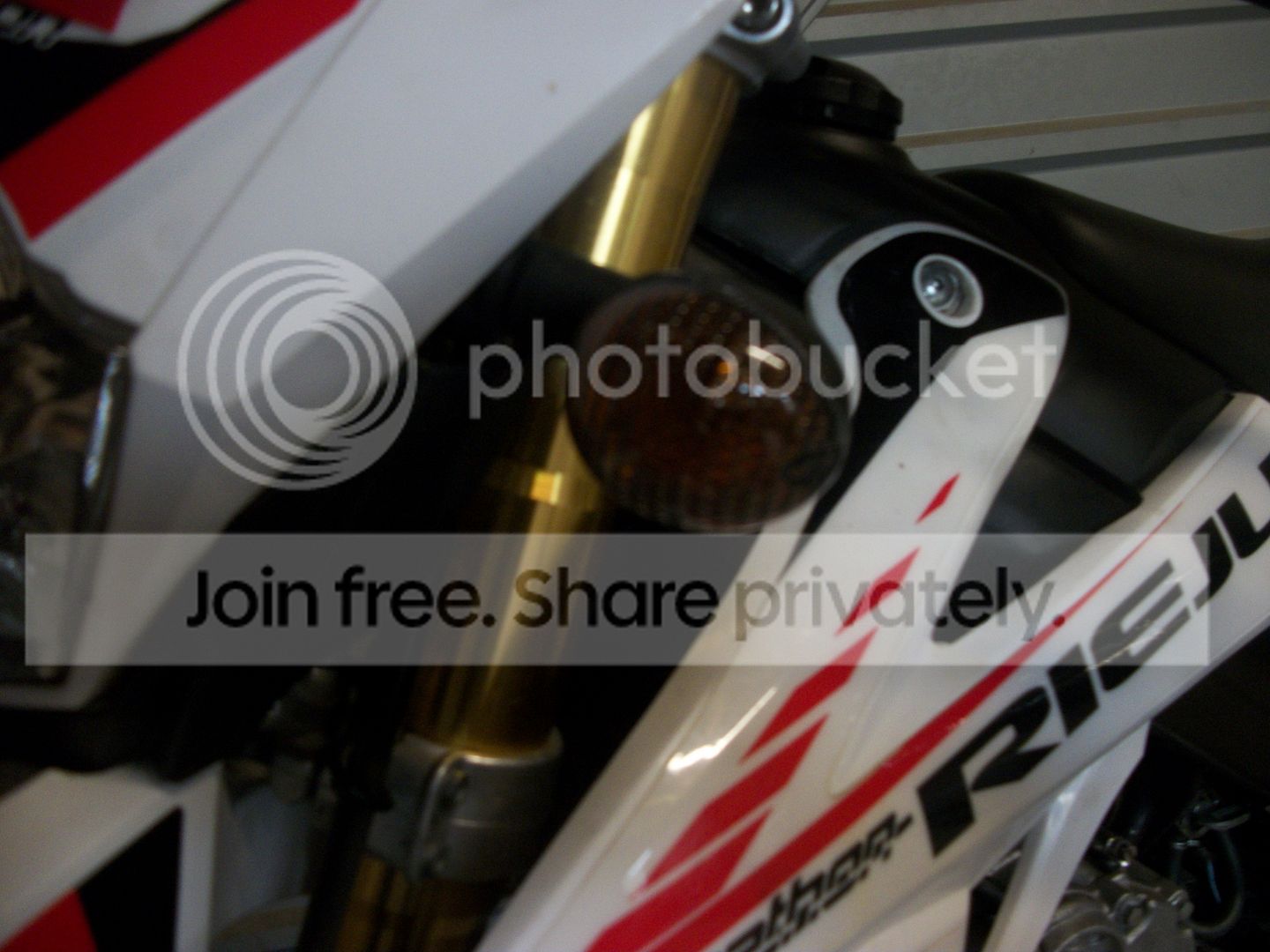

which has halogen indicators:
https://i116.photobucket.com/albums/o22/mmmbop_01/100_7858_zpsamgqtkux.jpg
https://i116.photobucket.com/albums/o22/mmmbop_01/100_7860_zpskxoqevmo.jpg

Unfortunately, the bulbs seem to be stuck. I can twist them anticlockwise a bit, but I then seem to hit a something and they won't turn anymore. I've used quite some force twisting them and i'm afraid that any more may break the bulb.
The bike itself is only one year old, has done 6000 miles and is in generally good condition. I don't think the problem is to do with water and corrosion (mainly because the indicators work) but it is more a problem with me and my mechanical inexperience.
Are indicator bulbs usually this tricky to get out? Should I use more force? Does anyone have any tips on how to remove them?

I don't think that method is working here.
I just went into the garage and tried again. I'm really forcing that bulb, but I had the same result as before. It moves about a quarter turn anticlockwise, then stops.
I think I need to undo something else first (maybe the silver reflective plate), or that the bulbs cannot be removed at all (which seems unlikely).
Changing the bulbs is not as easy as this this on my bike.
PostPosted: 15:06 - 04 Sep 2016    Post subject: Reply with quote
More force, your bike has identical indicators to most bikes. Give it a proper tug. You don'y need to so anything else. Also, LED, have you got a new relay to go with those new "worse" bulbs? I say worse as LED are directional, You won't see the almighty orange flashing from the side too well.
Have you tried pulling the bulb when it stops?
