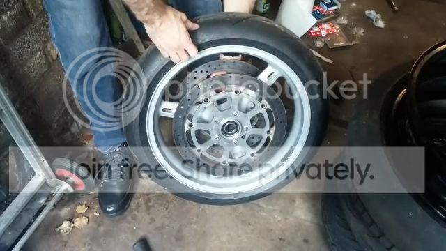

Bollocks I asked the same question last year with this pic:
https://i1133.photobucket.com/albums/m593/Kramdra/cbr600fwheelbeaing_zps096ef845.jpg
Also asked at mot and several garages... answer was that it doesn't matter, it will compress anyway when tighten spindle.
I assumed bearings should be driven fully into their seat.. why shouldn't they... Spacers should therefore be the correct length - the gap between the seats.
Service manual has a pic of bearing being fitted with a driver and hammer with the text "drive in left bearing squarely then distance collar, the left bearing with "special tool"". No idea what the special tool is??!?
No one gave me a correct answer... that its supposed to have an adjustment gap on the second bearing? so last year I filed the spacer down to the correct size.

PostPosted: 00:00 - 28 Jun 2015    Post subject: Reply with quote
Yep, the yellow spacer in your diagram is there specifically to stop the left bearing being pressed into the seat. They MUST be slightly longer than the seat-to-seat distance to prevent axial loading of the bearing.
As your manual says, left bearing first (for that wheel, on that bike) then spacer then right bearing. The 'special tool' is most likely just a threaded puller that pulls the inner races together.

Please explain. My understanding is that the spacer is there, so when spindle is tightened, the inner races are supported. If the spacer was the correct length it would be perfect.
Its been like this a year, 10k miles, and I do have a space spacer. Would you suggest I do it properly with new bearings or leave as is?

Well, there are two considerations - thermal expansion and manufacturing tolerances. You can all but discount manufacturing tolerances in this case but you can't ignore thermal expansion.
The wheel is ally which has a coefficient of expansion of 22m10¯⁶/°C, and the spindle is steel and it's expansion rate is half that of ally at 11m10¯⁶/°C. The only interface between them is the three bearings and their axial clearance, which is very small.
So if you take a wheel in winter at zero degrees then move it to summer at 30 degrees, assume the two bearings are 250mm apart, the wheel housing will have expanded 0.165mm in width but the spindle only increased 0.085mm in length. Now that might not sound like a huge amount but terms of bearing axial clearance it's like trying to force a sofa through the front door sideways.
To allow for this expansion and contraction, you have that little gap between the outer race of the second installed bearing and the 'seat' machined in the wheel hub.
The job of the tubular spacer is two-fold. It maintains that gap and provides a solid support between the inner races of the bearings so that when you tighten the spindle nut you're not loading the bearings axially (basically it stops you trying to pull the inner race out of the bearing by tightening the spindle).
