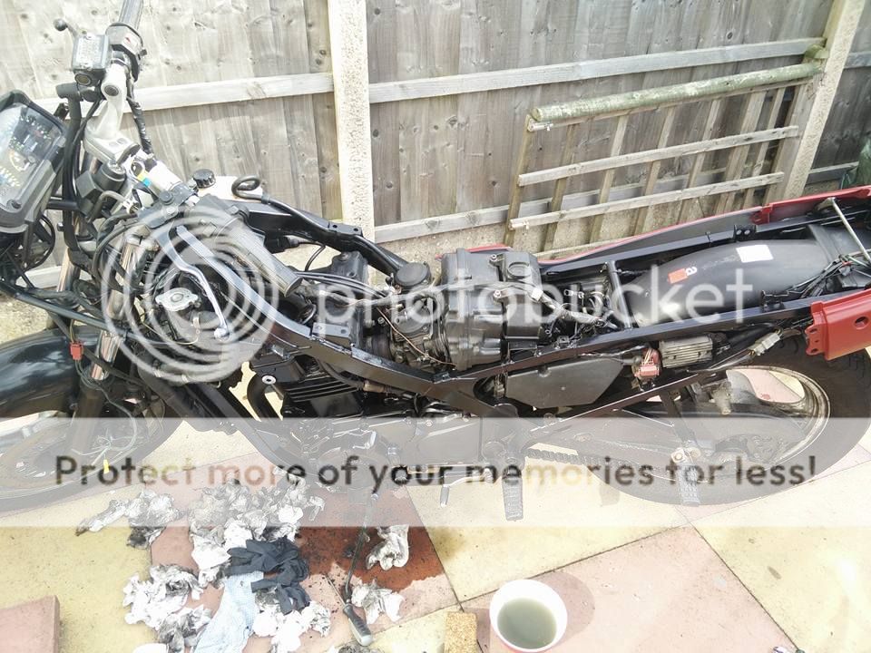

I used hammerite 'straight to rust' spray on my frame
I don't have a before the rust pic but this is the frame mostly done
https://i4.photobucket.com/albums/y109/Stevie_J/14292238_10153692832280810_5569473529680987088_n_zps2yogcsks.jpg

gpz repair kits for fuel tap (diaphragm etc) are about £10 on ebay for gen 1, not sure how much for later,.
