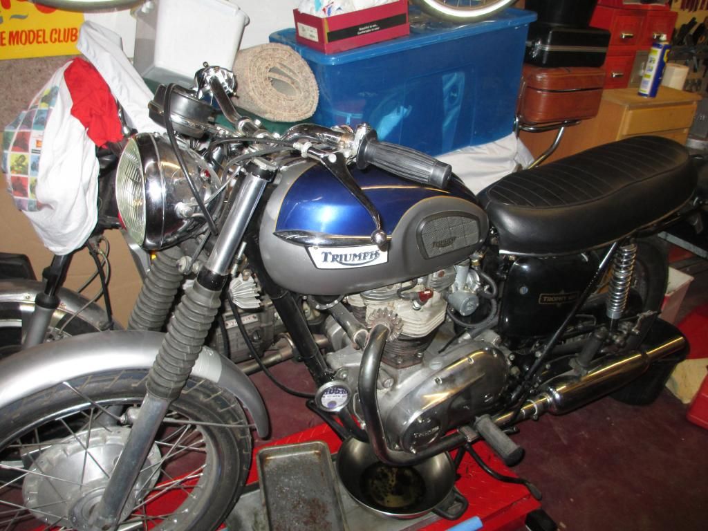

Right started it today Cool My mate Steve came round to give me a hand.
https://img.photobucket.com/albums/v295/chris-red/Bike%20back%20together/IMG_0112_zps435d67b9.jpg
There she is hiding in the back, the Four was kicked outside and the Trophy brought forward.

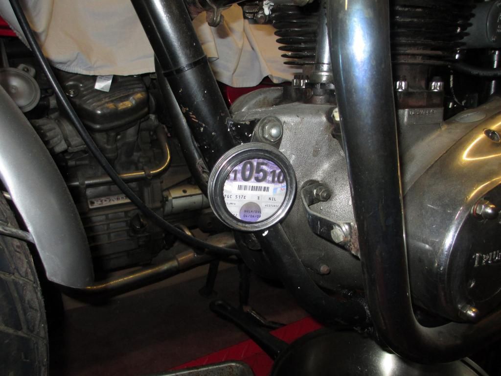

Last taxed

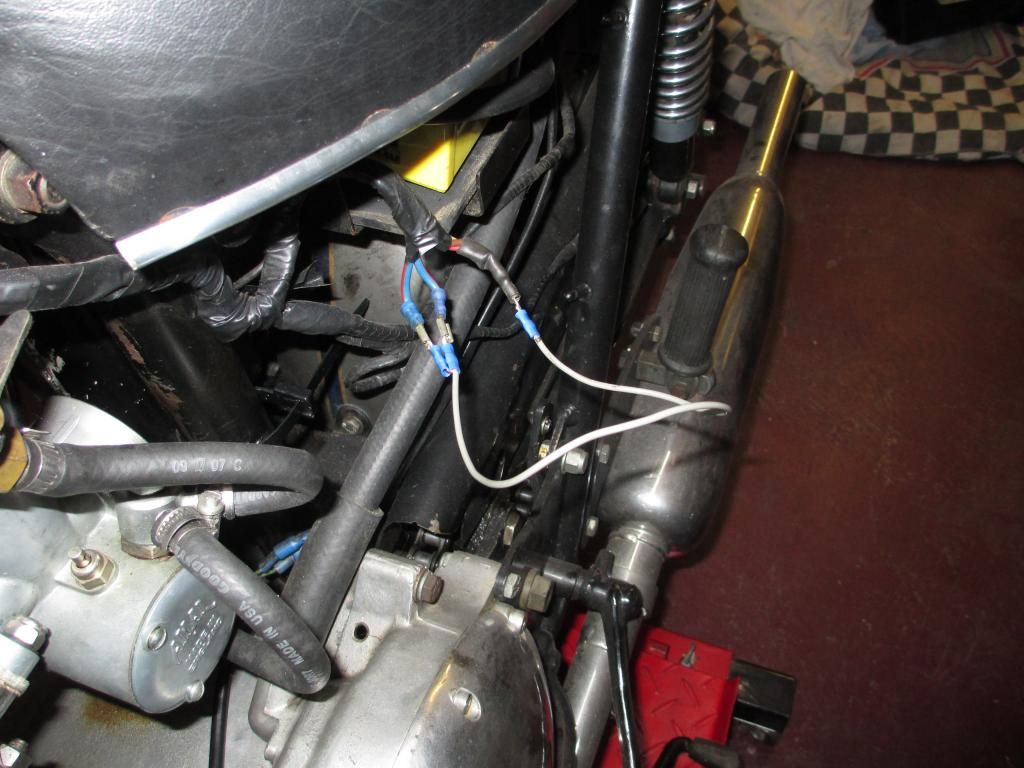

Next as dad has lost the keys we had to hot wire the bike. As you can see by the pictures below it was a really hard.
https://img.photobucket.com/albums/v295/chris-red/Bike%20back%20together/IMG_0117_zpsc069d4fa.jpg
https://img.photobucket.com/albums/v295/chris-red/Bike%20back%20together/IMG_0120_zps5fd3dcea.jpg
https://img.photobucket.com/albums/v295/chris-red/Bike%20back%20together/IMG_0121_zps71a43462.jpg
I was hoping to get a key cut for the barrel as it is easily removed any most locksmiths do this if I take it in?
