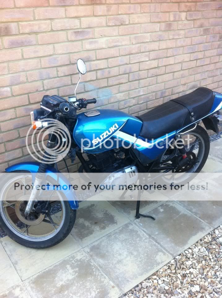

I have got an old GS125 up for sale but dunno if I'm allowed to post bikes for sale on here?
https://i531.photobucket.com/albums/dd352/GTR_turbo/GPZ600r/GS125.jpg
