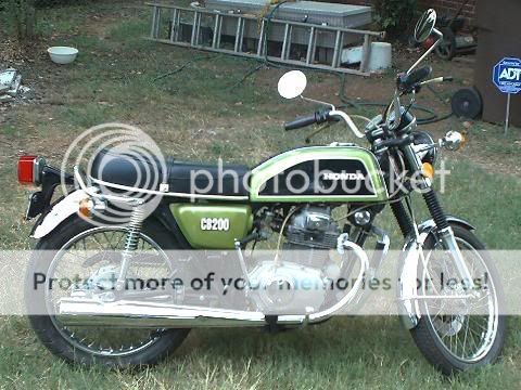

Is your bike one of these?
https://i104.photobucket.com/albums/m184/KnobHardcastle/hondabikecb200.jpg
I remember those when they first came on the market.They were rideable on 'L' plates and were not that popular as the CB250G5 was not that more expensive.As such,no other engine of a smaller size would be retrofittable.I think that Jock Kerr sold a big bore kit that took it out to 240cc or similar,but no small-bore kit.

It is yes.
If it`s one of those, just make it good and sell it on.
Why spoil a good little bike?
