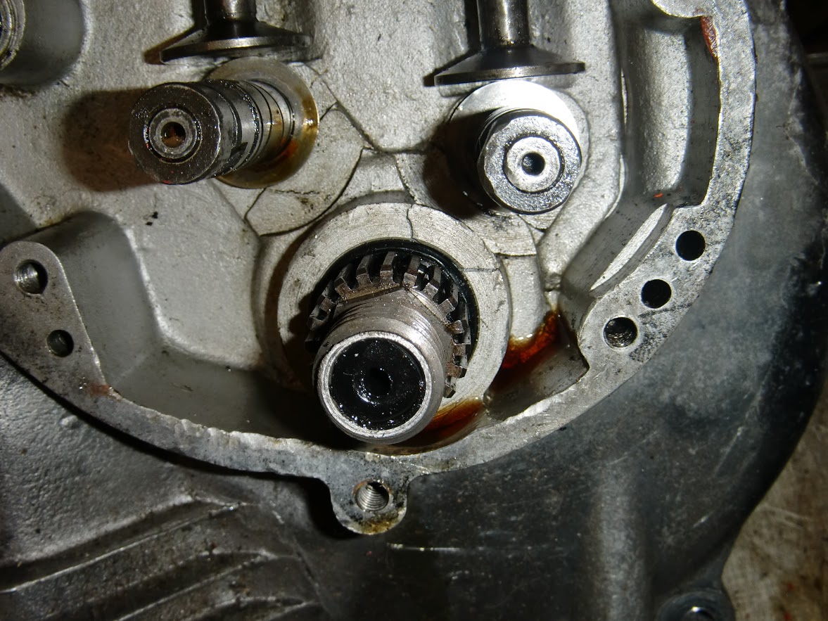

Ok, this has to be the work of the fuckwit owner. Helicoil that stripped thread? Nah, lets just fit a non load-rated cheese-head facing downhill so if it comes out, it'll drop stright into the timing gears.

Really nasty original rockers with rough as arseholes casting which appears to have been dressed by hanging out of a moving rickshaw and running it along the road. These will have to go.

Pleased I did take the motor out. Fuckwit has been at it again. Is that a bit of cheap (and now bent) threaded bar masquerading as an engine bolt? Gonna have to hacksaw it to bits. A proper one would have cost all of a fiver.
https://lh3.googleusercontent.com/c6V_1wK_hLZ6QITFsHVH4hoiMye4io2SGROfxnwVgzDapaEAk3pn5TwH2iOslEQJZt3EDzQRWds8ef82aCmB7zyK6-mbJUs55XKz5ptNTVE-ssto9Z83UpWn-TH4n15XQcUslbez_A=w1182-h886-no
The weirdest thing to my mind is that someone has spent a whole lot of time rebuilding that engine, then never started it.

Timing chest removed. If Bullet engines have a weak point, this is it. There is a worm gear on the end of the crank which meshes with a gear on a shaft runing in the timing case casting. This is the oil pump spindle. it rotates and moves the two oil pump pistons up and down. Excessive load on the oil pumps can lead to it stripping the gears off this spindle and the oil pumps stopping. Catastrophe ensues.
Speaking of catastrophes. Look at all that instant gasket compound inside my fucking engine!

Ok. Now hands up to a wee slice of fail. Could have been disastrous but wasn't in the end. The exhaust cam wouldn't come off. I assumed it was binding on the shaft and horsed it off with a puller. It was actually fouling on the crankcase casting. Had I rotated it 90 degrees, it would have pulled off by hand without taking a lump of crankcase with it. Embarassed.
https://lh3.googleusercontent.com/Dys36iRISA1rlV8KKsm0JGLNjkilkVlXO8xF8Esix50-Fui_iOFGiHuQXdK5XlltFjwTbT6c8LzwV233jw0TT1CK-xr2iNzM7t9YFKLNkugLqOTfumyDu4EdR4EFTgWYM1hknsl51w=w1178-h883-no
https://lh3.googleusercontent.com/AE4v9miMjvNGQPdGgDtRnpbU8wvUiI7QgZANxUKv2_VoqNpCoYm3Mb1A0vxn_nKmCDlNVWUF8kp1QVW1liVxa7blMWwZZHzgMIA9zHJcTyH92SejivEZj4dgPIhrwauMH9hLzZs9Lg=w1178-h883-no
This isn't actually a disaster at all. That bit of casting is a redundant lip that is in no way load bearing. It also needs to be removed anyway and a reasonable chunk more of the casting in that area relieving with a burr in order to fit the cams I want It is however my queue to stop messing with bits of the engine I've never touched before for the day before I do some real damage!
