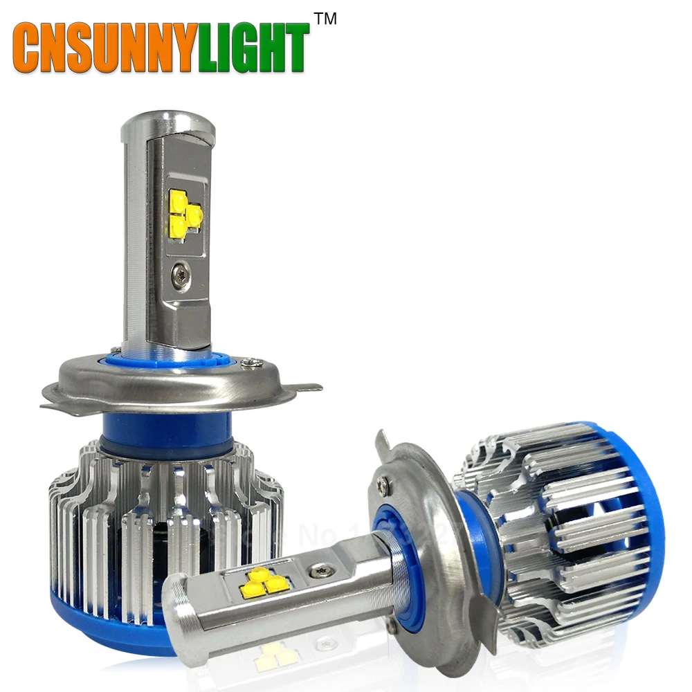

Looks like a crap design as how is the heat meant to leave the headlight enclosure?
All the semi decent ones I've seen have the heatsink and fan out the rear, so heat is being taken away. With minimal air flow in/out of the housing, that fan is just gonna stir the hot air around a bit.

https://sc01.alicdn.com/kf/HTB1bNSZKFXXXXbjXXXXq6xXFXXXJ/H4-Car-Led-Headlight-High-Power-Auto-H4-3-Hi-lo-HB2-9003-High-Low-40W.jpg
How they usually look.
Karma for the showing superbalic skills in photography Sir. Karma
