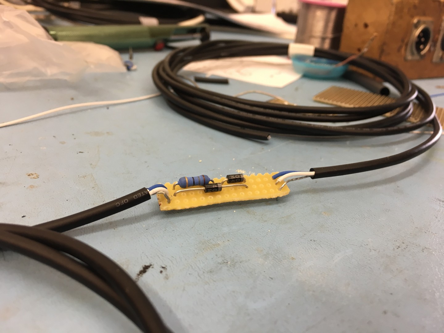

1. Started things off easy with a couple of resistors & a diode on to some board. Added some tails to either end, then heat shrunk it all over.

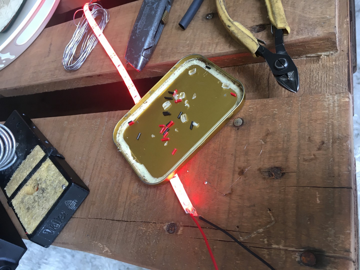

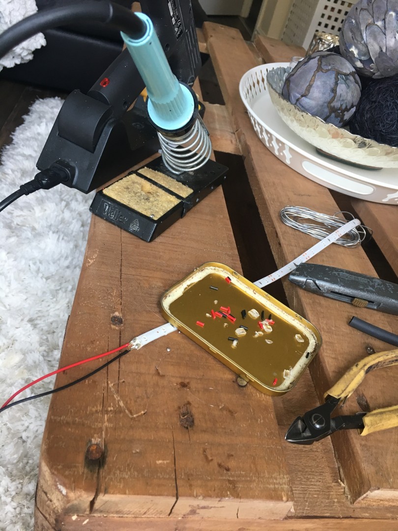

3. Time to start cutting, soldering & sealing with a glue gun on all the strips.

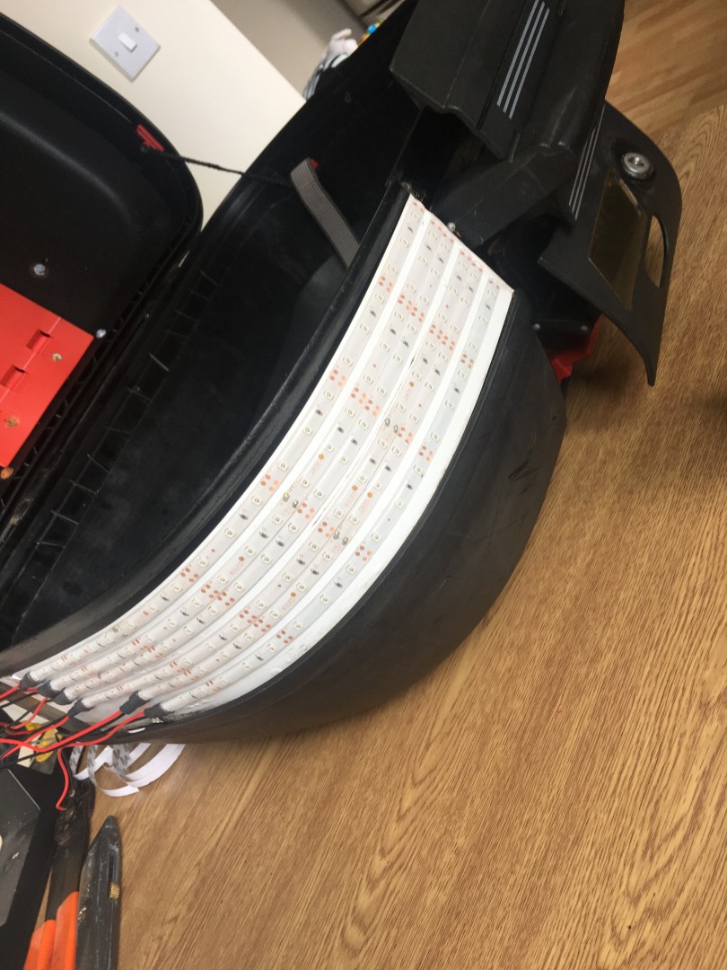

6. One side on.
https://cdn.img.versys.co.uk/IMG_7582.jpg
7. Second side done, wires wrapped, holes drilled & threaded through.

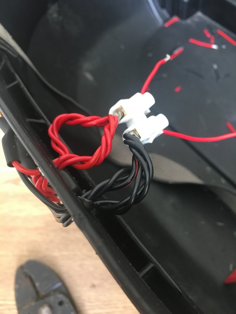

8. Internal wires twisted, soldered and screwed into a temporary block for now until i decided how to finish it off as neat as possible.
