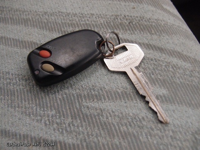

I wonder if the Deli unit does other stuff besides central locking?
https://cdn-www.cardealpage.com/carimage/1652294/11.jpg
Suggestions are you are looking for something like that.

I don't think it does, at least not as far back as 1995.
And the cocksuckers at Mitsu want £250 for a new one of those. Old ones are rarer than hens teeth.
