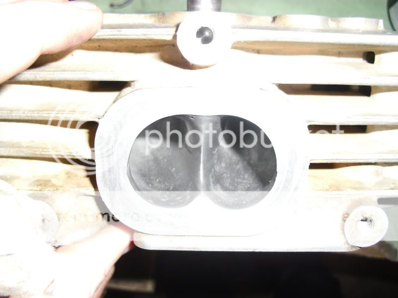

I polished up the ports on a single cylinder Honda a few years ago and it definitely let the engine breath better at all revs
https://i666.photobucket.com/albums/vv23/WiNot_Rhencullen/Workshop/CIMG2982.jpg~original
Smoothing the inlet tracts makes for far more of a difference than the exhaust ports.Just smoothing the casting marks and knife edging the ridge between the inlet tracts makes it worthwhile Thumbs Up
I have done the same to my Exup1000 cylinder head (20 valves Shocked ) and to a 5JJ R1 cylinder head and in both instances a smoother engine pickup and better throttle response was felt at all revs Dance!
I am looking forward to doing the same to my KTM 450 and XR400 cylinder heads at some time in the future Thumbs Up Very Happy Thumbs Up
