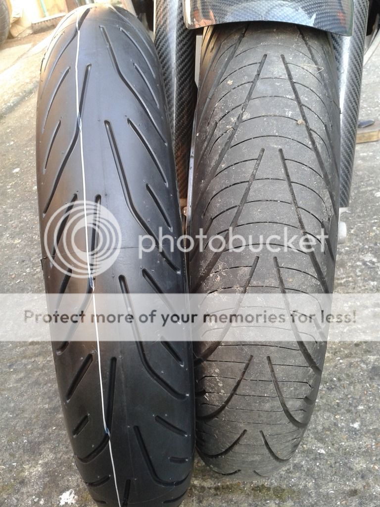

This seems to have happened to several people that I know who have had a Michelin PR4 fitted to the front of their bikes,a Suzuki V-Strom 1000 and a Yamaha R1-5PW in particular.In both cases they wore like a new £1 coin with abrupt edges.This I was told was quite disconcerting when leaning into corners and especially in the wet.
As for the wear characteristics between the PR3 and the PR4 I can only vouch for the PR3 wearing more evenly.I fitted one to the front of not only my Exup1000 but also the FJ1200.Both have worn very evenly,the FJ having covered around 3,000 miles around the Continent in 2016 and around 2,400 miles around France last year,with about 1,500 miles being ridden when back in the UK.The front tyre still looks good for a few thousand miles more.
https://i666.photobucket.com/albums/vv23/WiNot_Rhencullen/Workshop/20170324_155245_zpso1yuabhp.jpg~original
From my friends experience with the PR4 front I would be looking in the future to try the newer Road 5 instead
