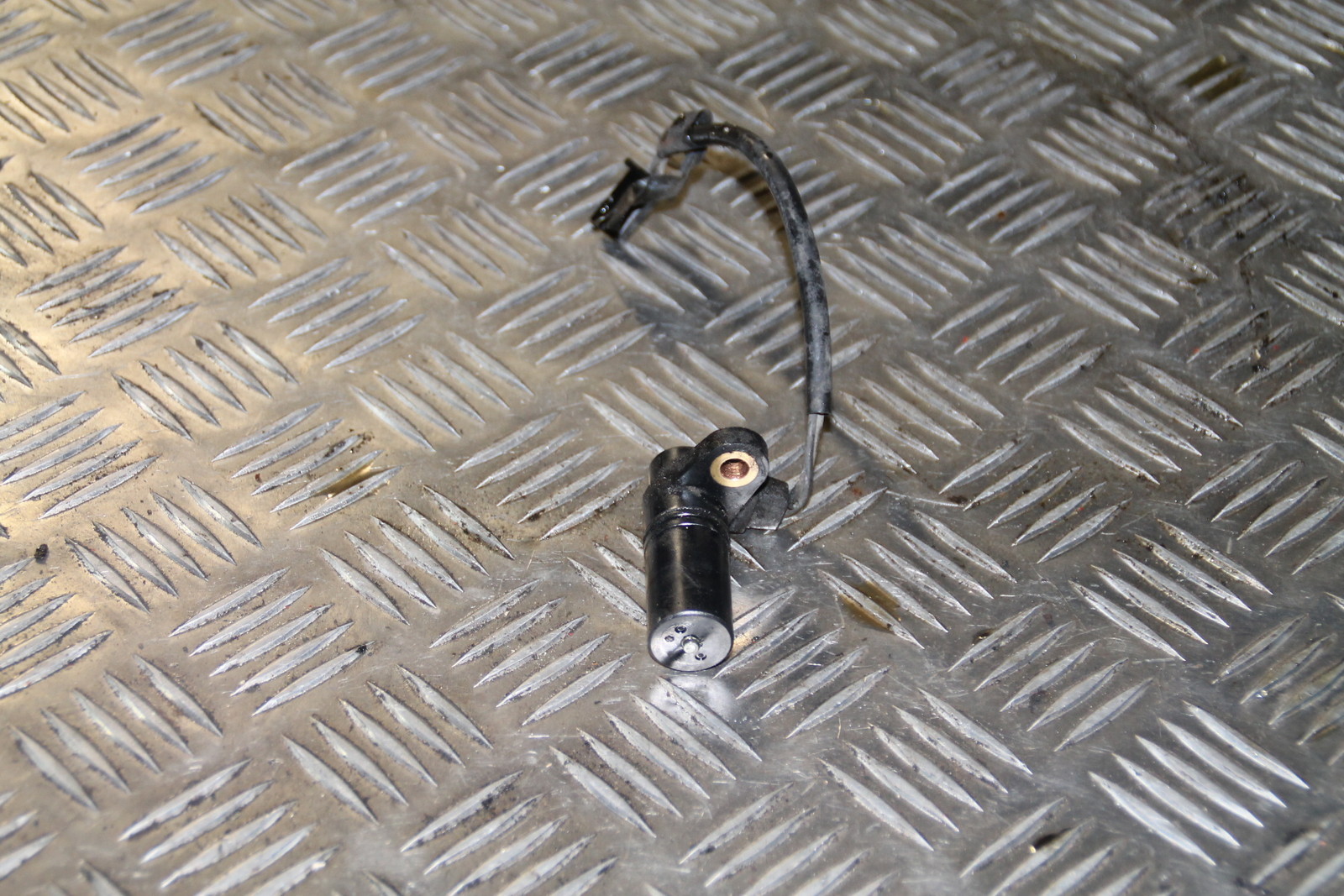

FYI heres one we made earlier
https://i.ebayimg.com/images/g/5YoAAOSww3tY5PFW/s-l1600.jpg
link
https://www.ebay.co.uk/itm/HONDA-NT700-NT-700-DEAUVILLE-2006-CAM-SHAFT-POSITION-SENSOR/173527403198?hash=item28670a0abe:g:5YoAAOSww3tY5PFW:rk:1:pf:0
