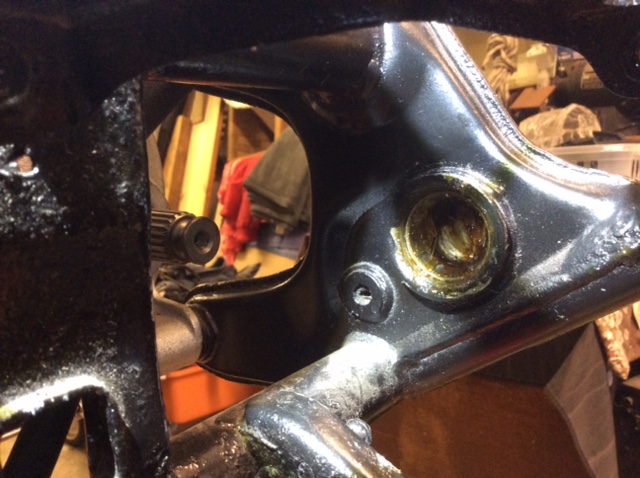

WD Forte
Joined: 17 Jun 2010
PostPosted: 22:05 - 04 Nov 2018    Post subject: Reply with quote
That outer race/cup isn't in far enough, it normally sits deeper than that in the holder (No 8)
https://www.bikechatforums.com/files/caabc82c-666e-464e-8a77-a6e7731310a1.jpeg
Like this
https://uploads.tapatalk-cdn.com/20140506/heve5ena.jpg
You SURE you removed the old one?
I cant see in enough detail but the position of the new one
suggests the old one is still in there

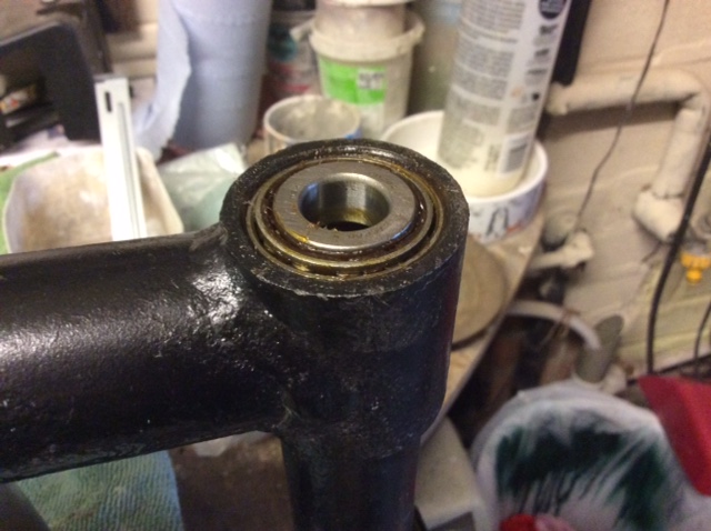

WD Forte
Joined: 17 Jun 2010
PostPosted: 13:49 - 05 Nov 2018    Post subject: Reply with quote
The crusty looking one is just a pic grabbed ofn the interweb to show how deep the raceshould be in No8 its holder, it aint Kens.
In his pic, it looks very much like he's tapped in a new race(cup) on top of the old race/cup.
Ken.
Further examination shows you've probably done the same on the LH side too mate.
That bearing should sit deeper in the swinging arm than that and when the oil seal is fitted, it should be flush with the outer edge.
https://www.bikechatforums.com/files/573a8208-d014-4d2d-a61a-cbf91516bb55.jpeg
My advice:
Stop what your doing, clean it all down and remove those new races.
they may get damaged in the process
Then you have a choice.
Remove the old cups and fit new or take a chance and re use the old cups with your new cones
David Silvers want about £15 plus vat and postage for each bearing
(admittedly they're NSK and a quality make)
But
Those bearings are just a common 30202 (make a note of that number) and easily sourced.
For instance, simply bearings flog em for £3.68+vat upwards depending on quality ( budget/good/high)
https://simplybearings.co.uk/shop/advanced_search_result.php?sort=2a&search_in_description=0&keywords=30202&gclid=EAIaIQobChMIhvDemaK93gIVy7TtCh1fngUHEAAYASAAEgJBtvD_BwE

KenB1951
Joined: 01 Nov 2018
PostPosted: 21:16 - 08 Nov 2018    Post subject: Reply with quote
Hi WD. I am sure you are right I must have stupidly fitted new races on top of the old ones not realising they had to come out . i phoned David Silver Spares where I obtained the bearings and they said they would have come with races .I can see your idea of 2 drill holes and thin punch through holes to get old race out although now I have one on top of another , heating swing arm would help I`m sure . What`s best way to get left hand side sorted? Honda due not do pullers for these bikes anymore , can I get bearing remover from some where else or get something welded on to assist with removal ? Blimey I have made a right dog`s breakfast of this , but thanks so much for all your help on this .
Kind regards Ken.
