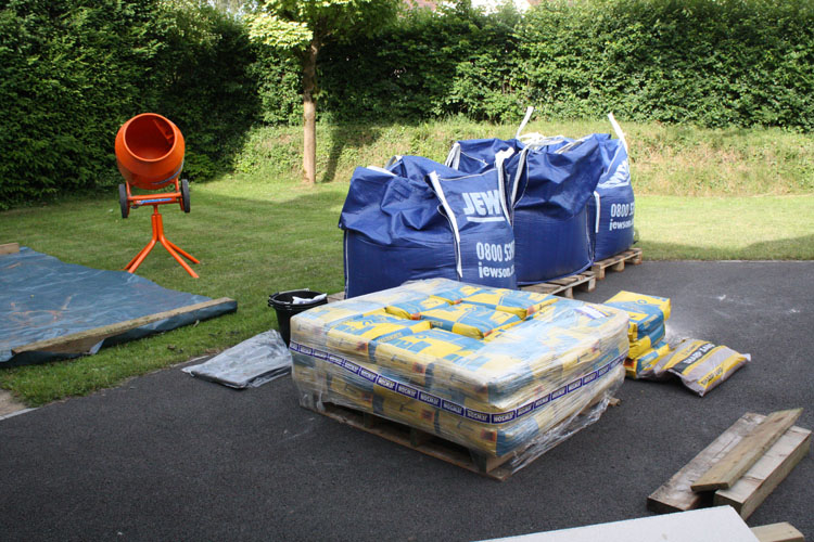

Been there, done that. It's not that difficult but it does give you a decent workout. Here's a picture - there's another pallet off camera. I had to move it 50m - I decided to barrow it after mixing.
https://www.amigo.co.uk/obsy/10.JPG
