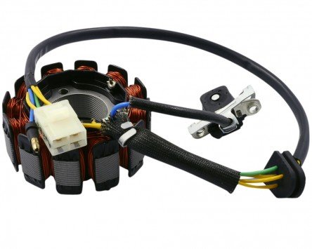

PostPosted: 23:48 - 26 Jan 2019    Post subject: Reply with quote
aka 'ckp'
It's that little thing hanging off the stator

Sammydroid
Joined: 21 Mar 2018
PostPosted: 01:46 - 27 Jan 2019    Post subject: Reply with quote
Really hope it’s not that with a 50 quid price tag

Sammydroid
Joined: 21 Mar 2018
PostPosted: 17:29 - 29 Jan 2019    Post subject: Reply with quote
Well, had the stator cover off and it looked like someone had tipped melted vanilla ice cream in it Confused I think theres a slight chance my head gasket might have gone
I cleaned up the sensor and the bike ticked over fine (although i dont think i should have started it in hindsight) so it wasnt broken just dirty
