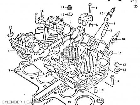

https://images.cmsnl.com/img/partslists/suzuki-gs550e-1981-x-e01-e02-e04-e18-e21-e22-e24-e25-e26-e30-e34-cylinder-head_mediumsue0126fig-2_b849.jpg
https://images.cmsnl.com/img/partslists/suzuki-gs550e-1981-x-e01-e02-e04-e18-e21-e22-e24-e25-e26-e30-e34-cam-shaft-valve_mediumsue0126fig-9_7de1.jpg
https://images.cmsnl.com/img/partslists/suzuki-gs550e-1981-x-e01-e02-e04-e18-e21-e22-e24-e25-e26-e30-e34-cylinder-head-cover_mediumsue0126fig-1_0f28.jpg
this may be your bike but look at your exact bikes exploded views.
It may be possible for the engine to run safely ( apart from the mess ) with the cam cover off, FIND OUT!!!
If the cam cover off does not effect cam timing then turn engine over BY HAND with the plugs out and watch that all valves open and close all ok. ANY "clunk" or solid feeling, with virtually no torque applied, means something is not right, and further rotation will DAMAGE STUFF.
If the engine turn over with the plugs out freely ( remember there will be some resistance due to valve springs etc ) , you can whizz away on the starter, but check for oil flow to the head.
THIS IS STEP ONE.
step 2 is check for ign. Even a finger up one plug cap can be "informative", but red neon plug caps ( i need to buy shares in the company that makes these little beauties!! ) are a good inexpensive method of checking for HT, and HT loss.
Step 3 is fuel......come back when you are ready to add fuel, but once the engine is running ( NO REVS ONLY IDLE SPEED ON OILY PETROL AND A TEST TANK OF ! LITRE ) check the charging system!!
remember brakes and the clutch will probabl;y be stuck/ in need of tlc BEFORE YOU RIDE THE BIKE ANYWHERE.....see similar threads and do your research!!!!!

https://images.cmsnl.com/img/partslists/suzuki-gs550l-1981-x-e01-e02-e04-e21-e22-e24-e25-e26-e34-e39-cam-chain_bigsue0125fig-10_39cc.gif
in this view the top run of the cam chain is straight but has a guide, meaning it would be ok to turn the engine over with the cam cover off, and, probably ok ish to run the engine with the cam cover off at idle, but that run of chain may tend to "whip"........so dont.
It would be safe to turn the engine over to check and see valve operation and clearance checking.
