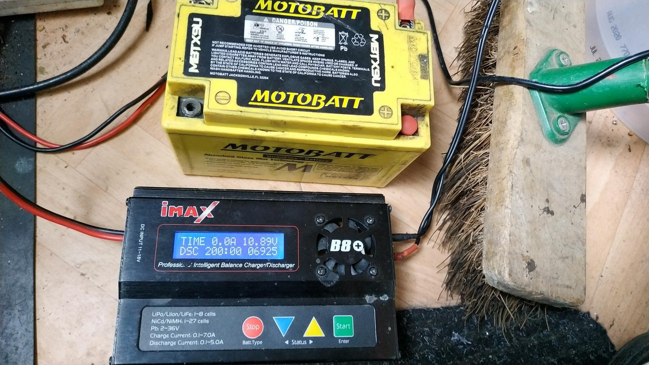

Got this in 2012 at about 35k miles. Removed from bike at 108k and has been sitting in cold shed for three weeks - I did attempt a quick charge but within 10 seconds it stopped saying full. I have bought a new one for the cbr6, the plan being this will go in a 125 that will see mhch less use. Using an imax b8 charger to test set at 2.2A.
Mbtx9u is rated 10Ah (over a 20 hour discharge), so I was interested to see what it had left.
https://i.postimg.cc/hvyQ7nDq/IMG-20190427-135819.jpg
https://i.postimg.cc/c4z8xdkR/IMG-20190427-142605.jpg
8ah over 227 minutes (3h 47) Thumbs Up

You had a good one.
Although a longtime advocate of motobatt I do read occasional gripes...no problems myself.

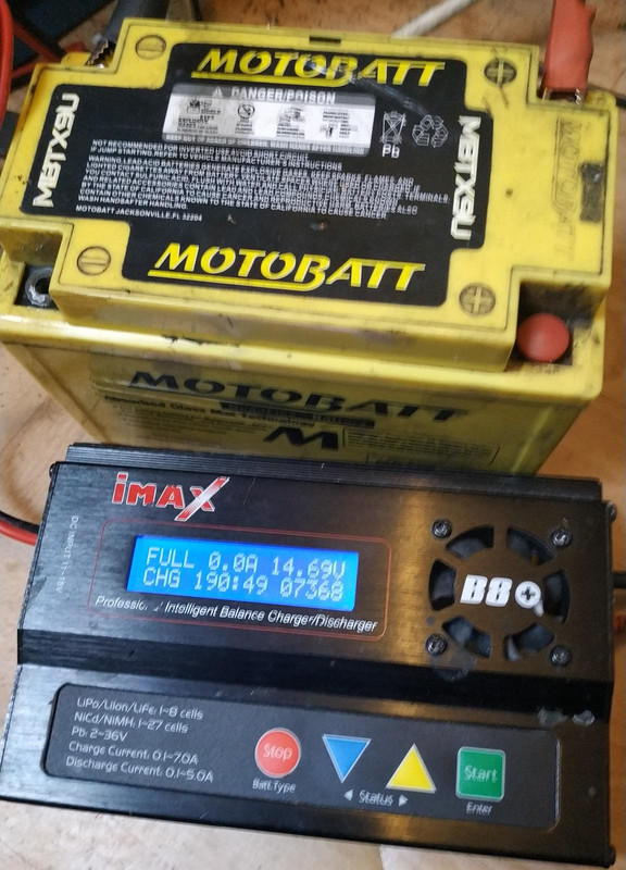

https://i.postimg.cc/8zJySq67/IMG-20190427-174123.jpg
Full. 7.3Ah
