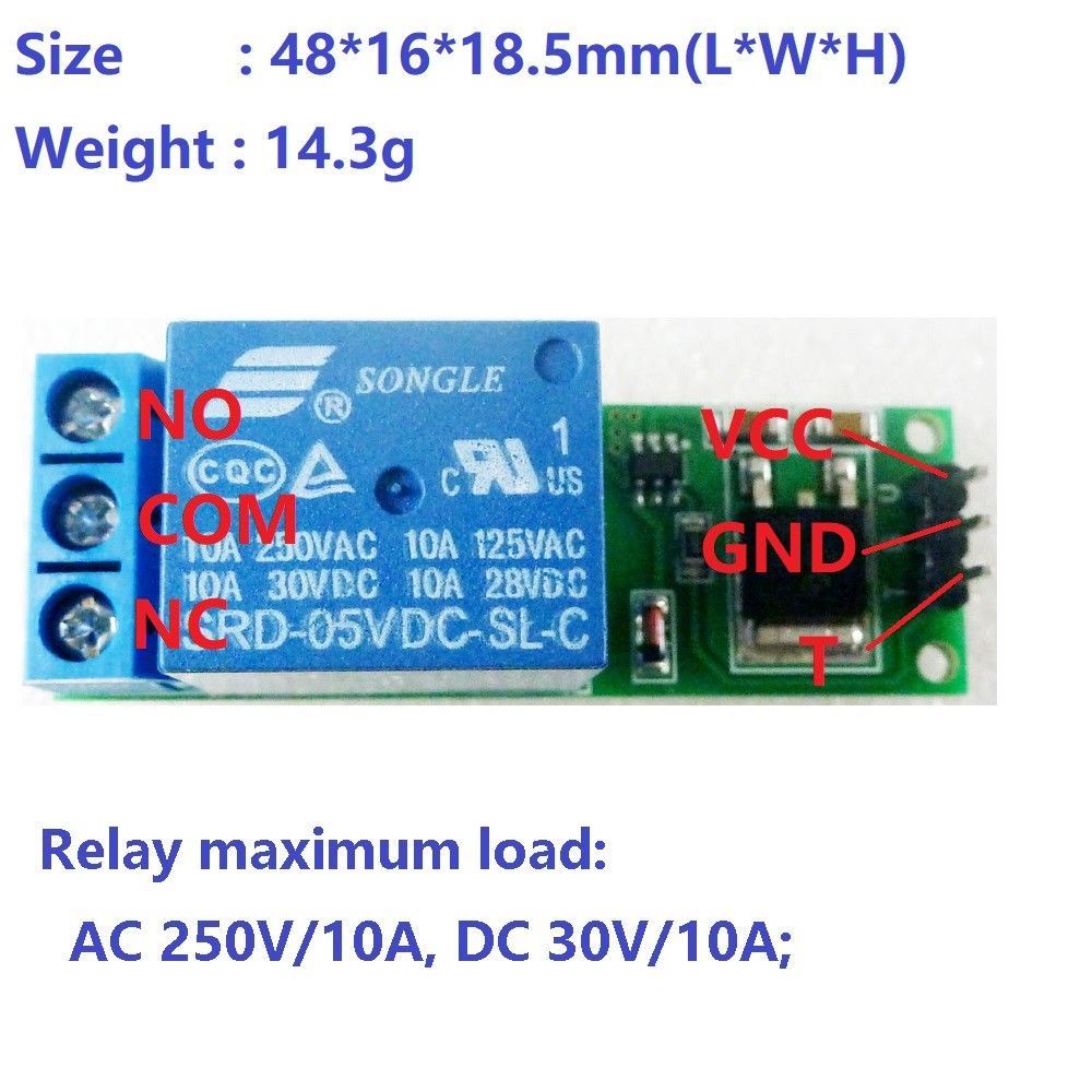

I'd use the 2 momenetary bar buttons to Trigger 2 active low flip flop type relays one per side
and a common flasher unit.
You'd have both normal and hazard functions as well by pressing both buttons
Cost less than a tenner all in, no voltage level shifting or coding, easy to wire and fix/maintain
forget silly tilt cancel and sos flashing options.
You can buy these for about £2 each
I've been running 55/65W headlights through those Songle relays for years and they're well up to
running flashers, I'm using them on my current bike mods
Simple connections
Power to flasher unit, pulse out to each COM and each NO connects to L or R flashers
T get grounded by bar button/s to activate

The boards I pointed out work at 5v as the big black chip is a 7805 5v voltage regulator.
I see a flywheel diode across the relay coils and a few resistors
and a 6 pin IC which is presumably an (SR type?) flip flop which toggles the relay on and off when T is pulled low.
Those Songle relay coils have a resistence of about 270 ohms IIRC so coil current will be low,around 20 milliamps at 5V.
I reckon you could drive the push buttons at 5V too to minimise any bounce if you felt they needed it.
