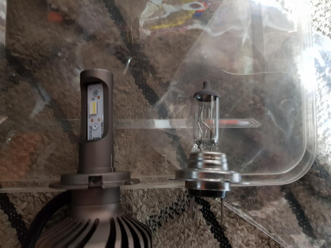

https://i.postimg.cc/sfP7dvtp/00-Side-By-Side.jpg
The bulb ‘filament’ area matches up with that on a standard H7 halogen. This looks promising. There's an array of LEDs on both sides.

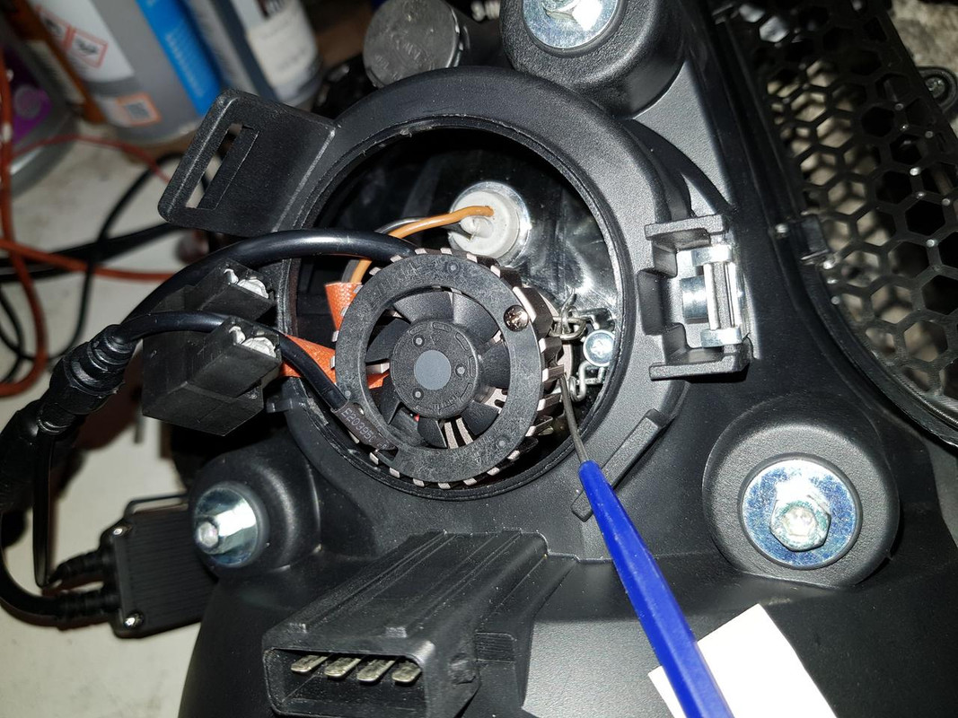

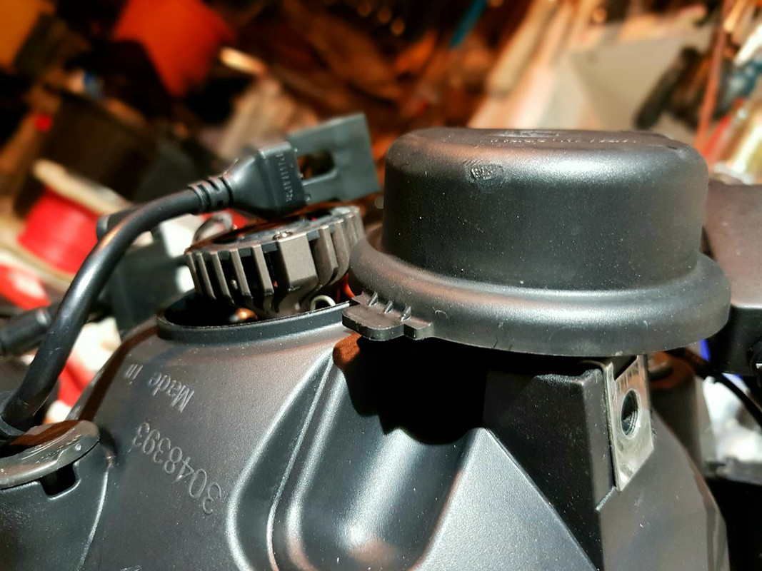

With the lamp removed, I installed the LED unit in the aperture and snapped into place the retaining clip, a dental pick was required as there’s no finger room left when everything is installed.

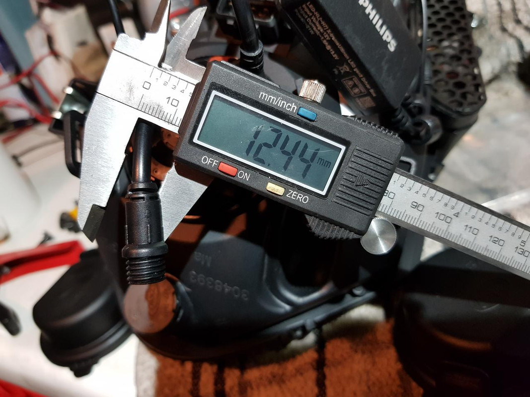

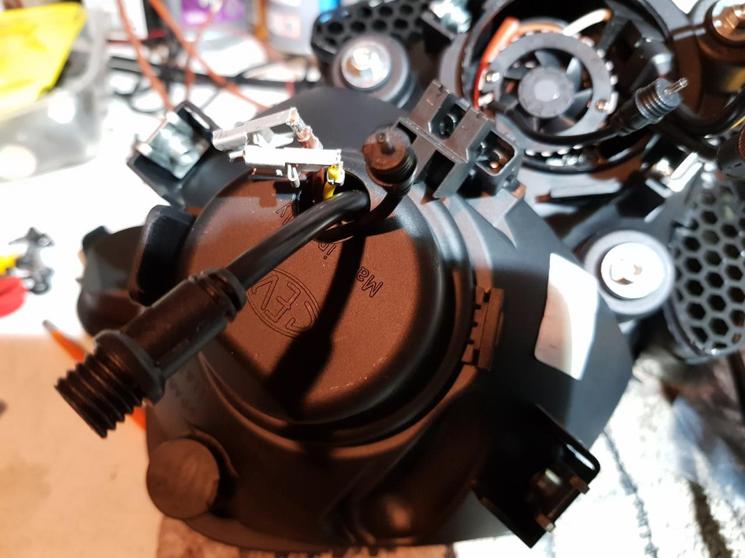

A check on the size of hole that would need to be drilled in order to pass through the electrical feeds. On a car they recommend you fit everything inside the headlamp and seal it all inside. This is not possible with the RC8, there was only just enough room inside for the light, so the drivers and connectors will be located outside behind the headlight - hence drillage and fillage.
https://i.postimg.cc/c4vNV8zH/06-Fitting05.jpg

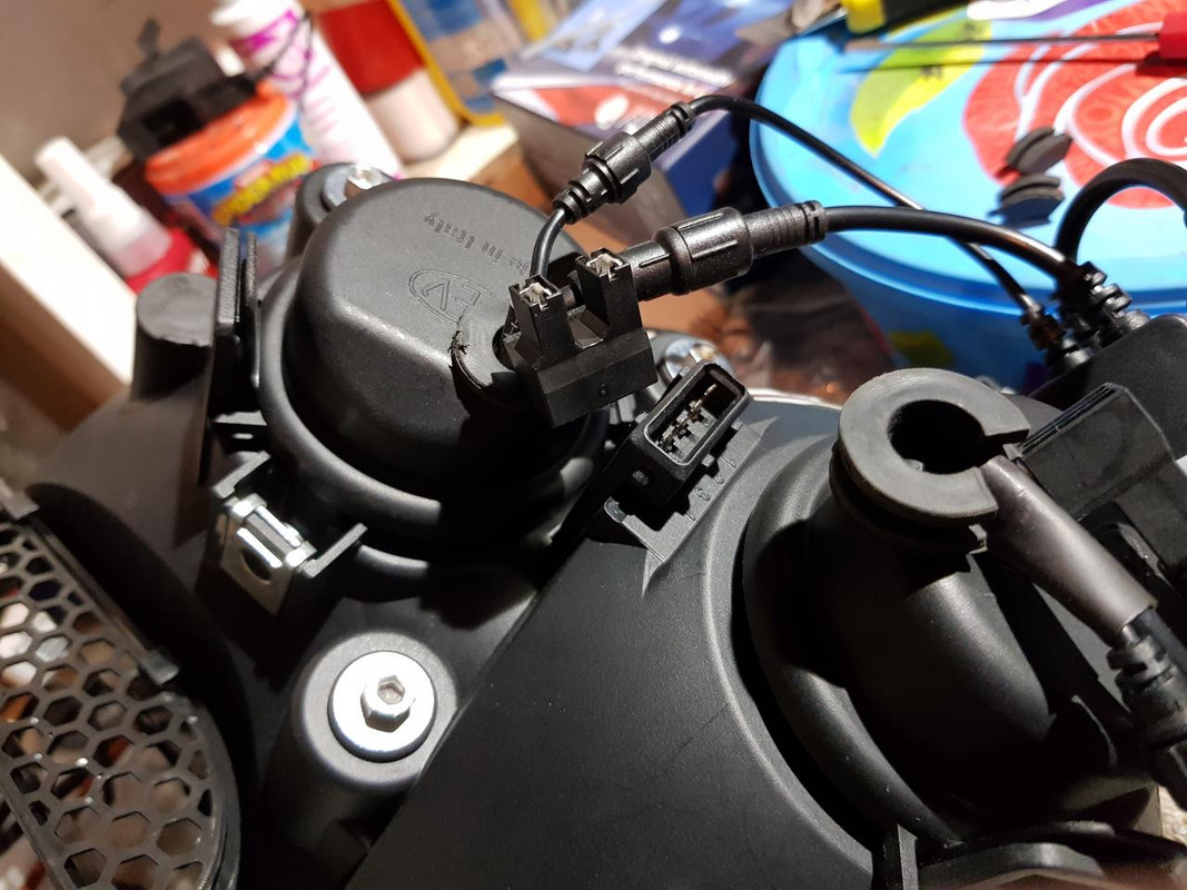

Hole drilled and deburred, wires passed through – H7 bulb connector will be put back on in due course.
https://i.postimg.cc/TPB622Wx/07-Fitting06.jpg
All connected up, trimmed down some grommets to pack the oversized hole and give the wires an easier life. Added some heat shrink just to be sure.

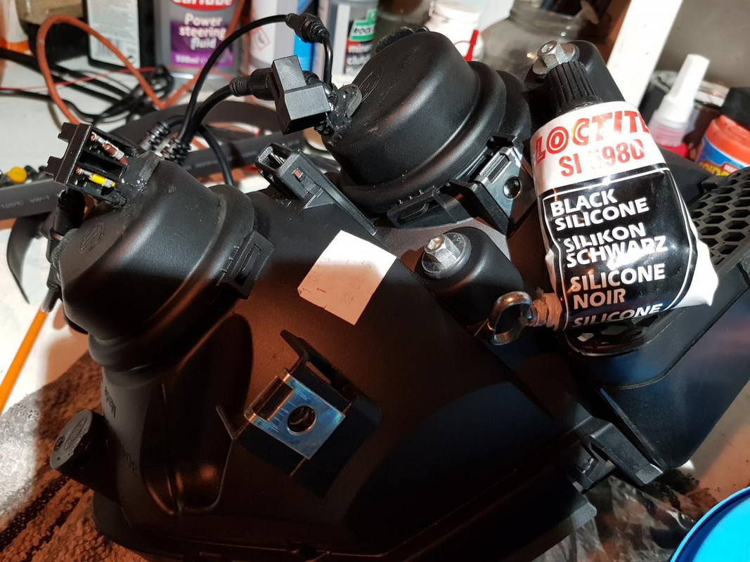

A bit of the old universal black gloop to seal it off a bit better. This doesn’t need to be 100% waterproof as there’s other connectors behind the headlight that are also exposed - these sit above a splash shield.

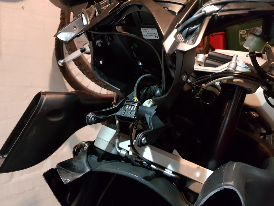

Now to stuff all of that in here – it was very tight and the dash display unit was removed to see exactly what was going on. Main concern was keeping wires away from chafing/trapping and not pressing upwards on the back of the dash. In the end both driver units ended up in the lowest half of this recess area, above the splash shield and just below the OEM connector.

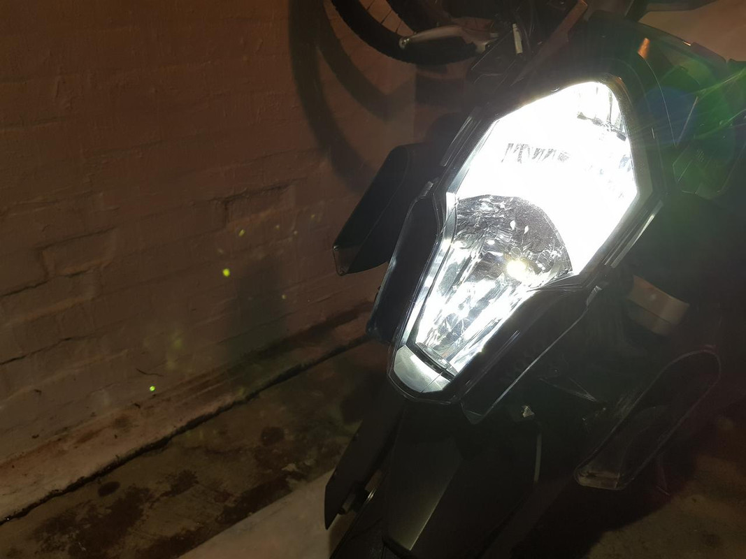

Testing the unit, before refitting the bodywork. Made sure the LED cooling fans were heard to be spinning, and main beam plus dipped beam came on as planned. I put in an LED 5W sidelight while I remembered I could swap it out from the CBR600. Would not have been best pleased with myself if that bugger blew and had to be replaced.

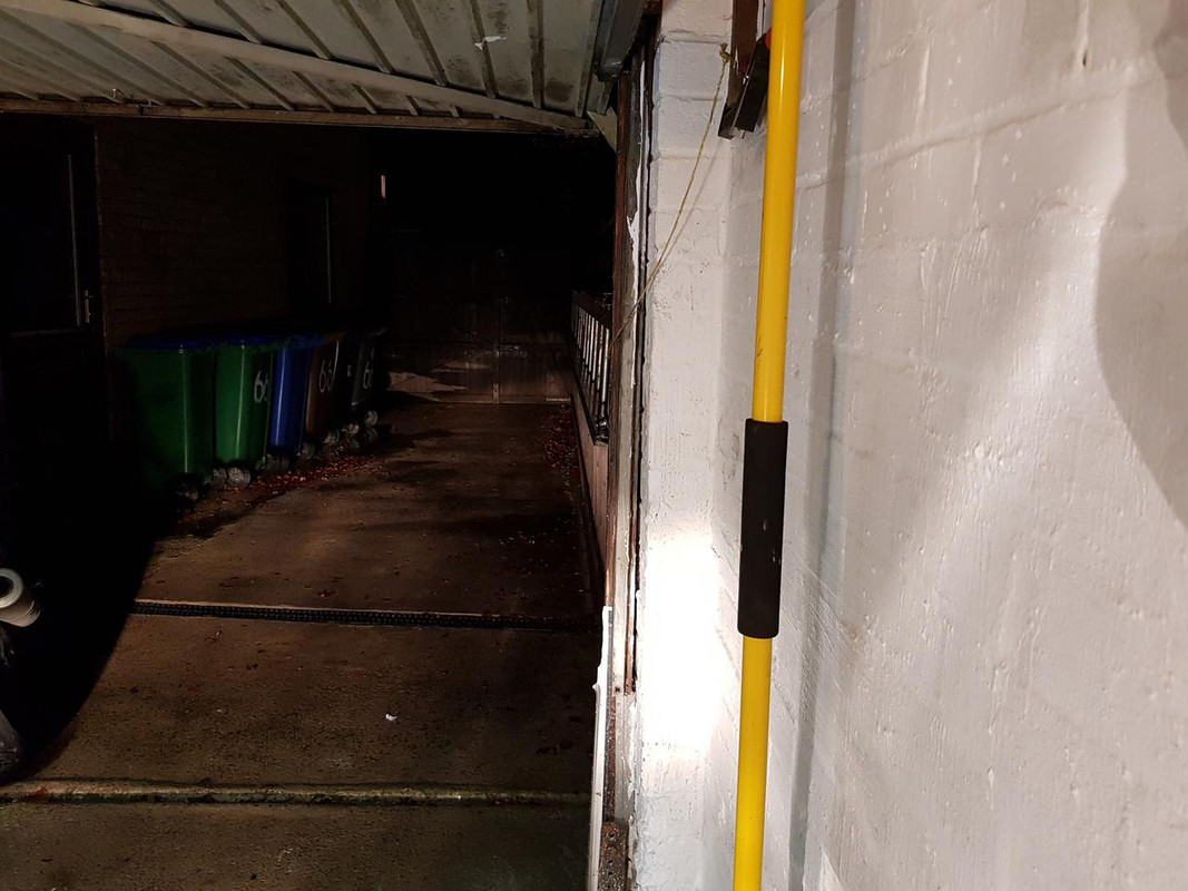

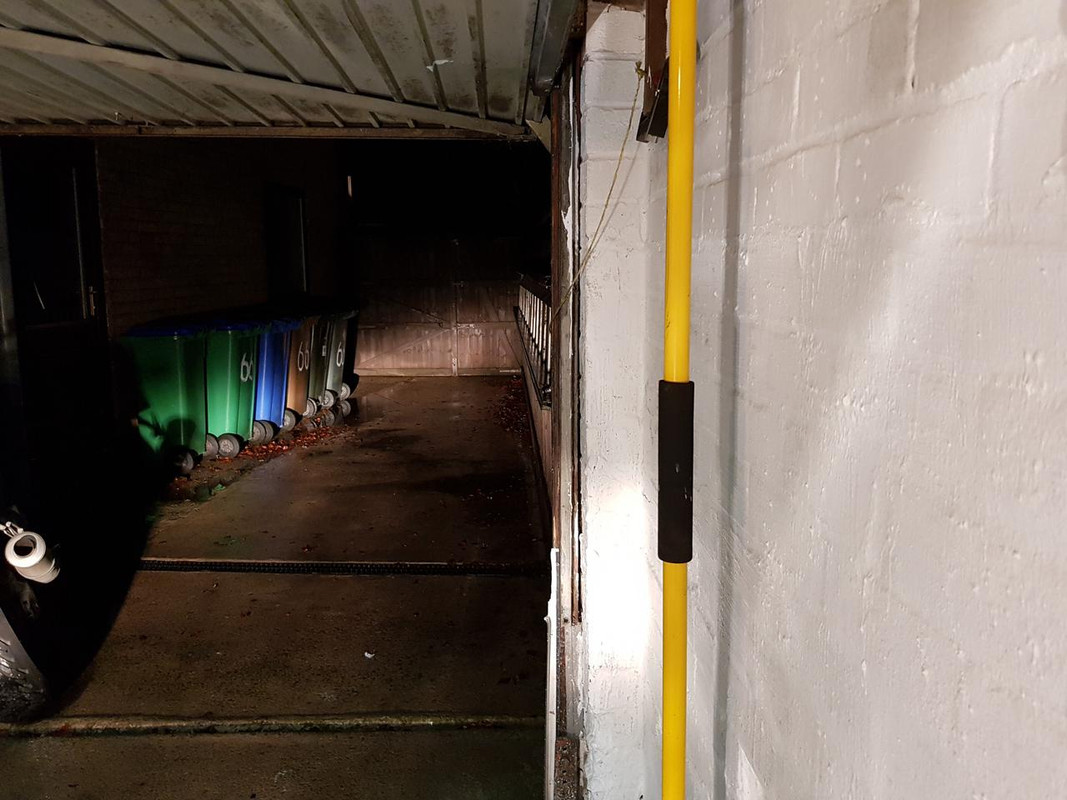

https://i.postimg.cc/J7vTzTxb/11-Halogen-Low.jpg
Beam test – this is before – H7 halogen low beam. A bit of reflection from standing water, and the lamp is aimed a bit low. In real life this is adequate. Meh!

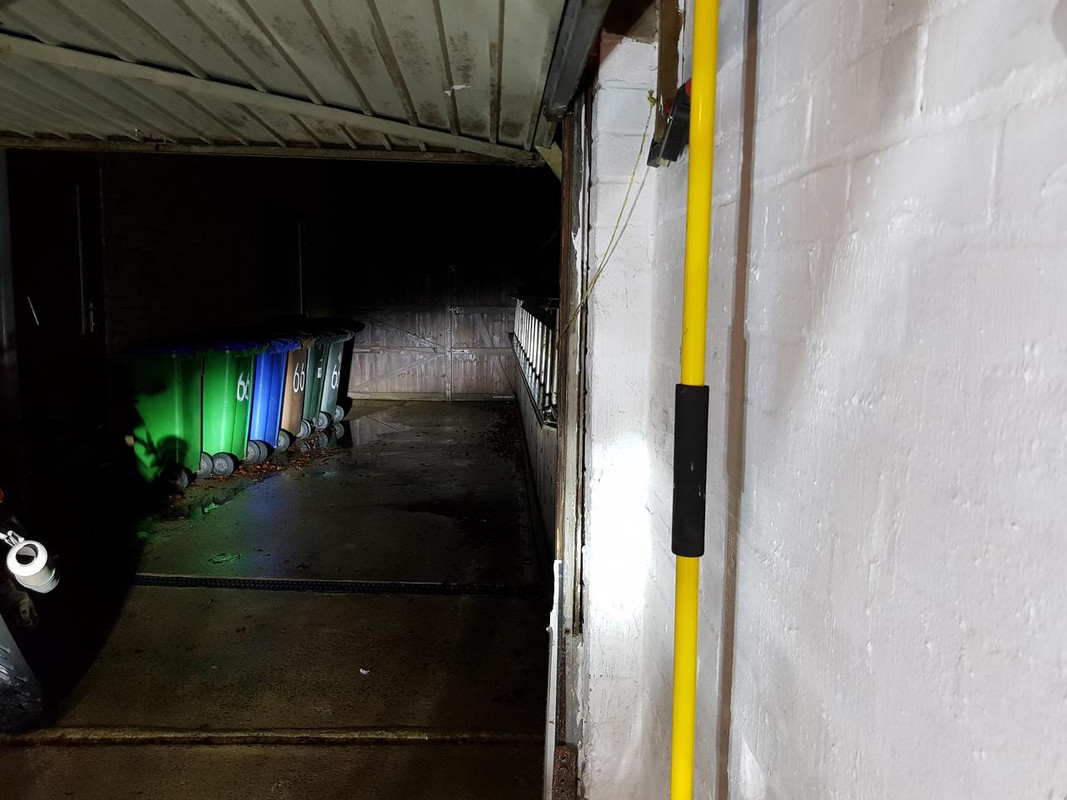

https://i.postimg.cc/9M3MMHD6/12LedLow.jpg
After... H7 LED low beam, nice horizontal cut off, noticeably brighter, good hotspot and shadowing is not too bad.

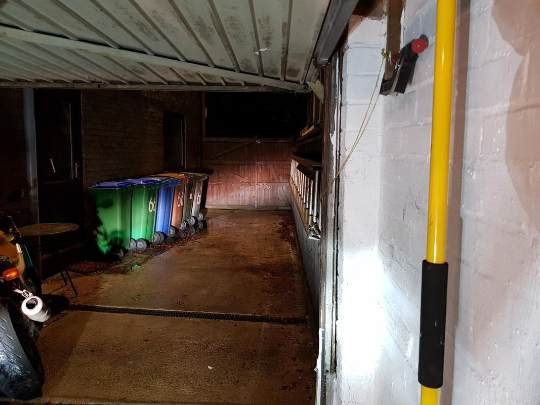

https://i.postimg.cc/MKrzHJ49/14-Led-High.jpg
After... H7 LED high beam – in fact the RC8 lamp units are separated so low and high beam come on together whenever high beam is on. Thumbs up from me.
