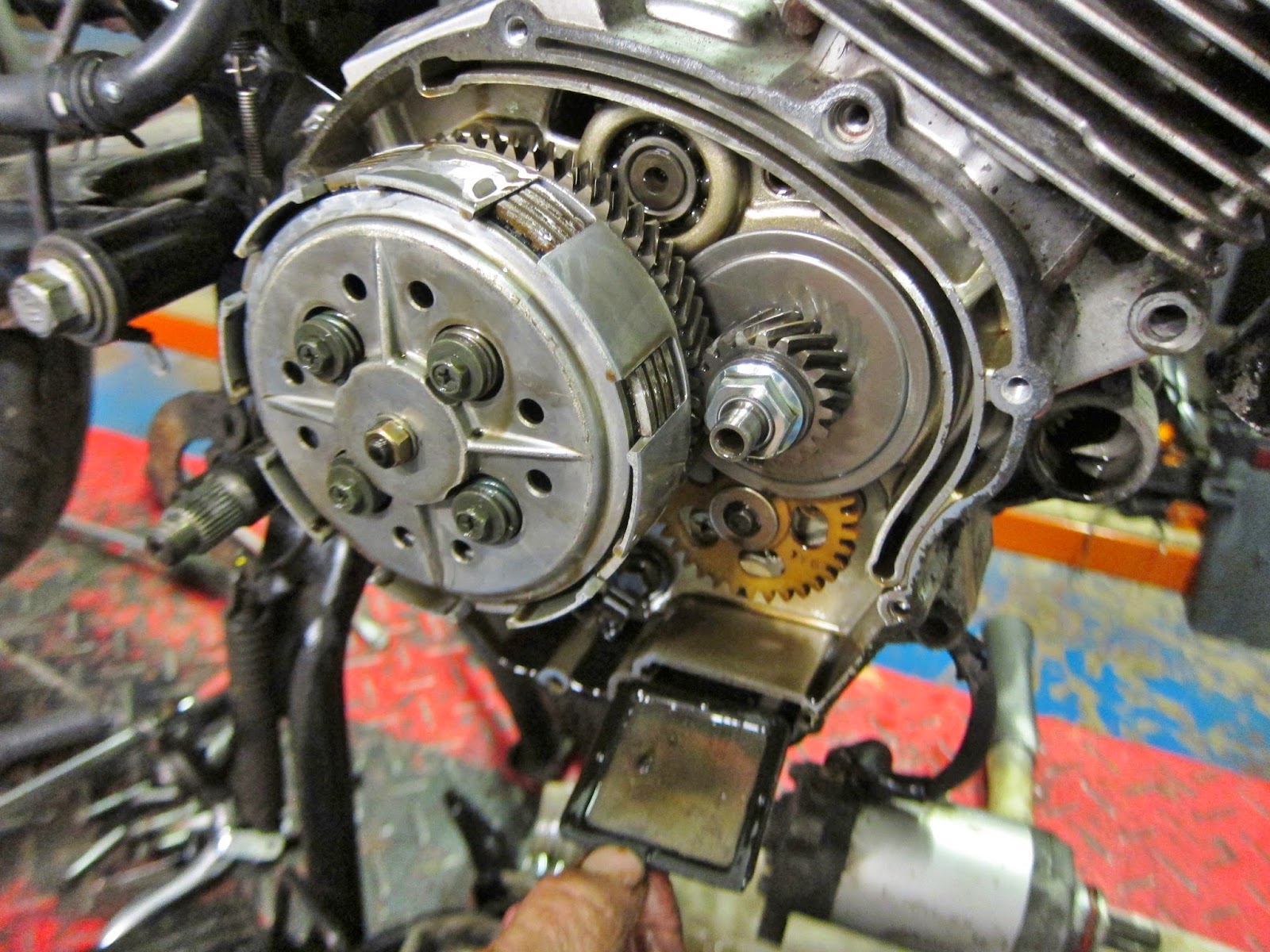

Plastic oil pump drive gear looks worn - teeth are probably pointed when new but are they leaning too?
Why was that case off? Only thing I can think of is new clutch plates?

I'd be wondering what happened in 2000 miles to warrant removing that cover. Personally I might have checked the oil level a few times in 2000 miles but thats about it. Rolling Eyes
Also if he's ham fisted enough to shear those bolts, what else has he buggered.

Either of those should come out readily. If tapping on the end with a flat-ended punch doesn't loosen them enough to twist out then a flat penny washer over the end of the hole then a blast with a mig will weld the washer to the bolt end and expand the ally case a bit so they will turn out either by bending the washer edge up or welding a nut on top.
The oil pump gear looks fine. They are often odd-looking profile-shifted gears on oil pumps.
Oil strainer is located there.

As above, the only reason i can think of is someone wanted access to the oil strainer but at an alleged 2K it makes me wonder why.
The high engine number and condition of the rest if it does suggest a late year and low miles.
