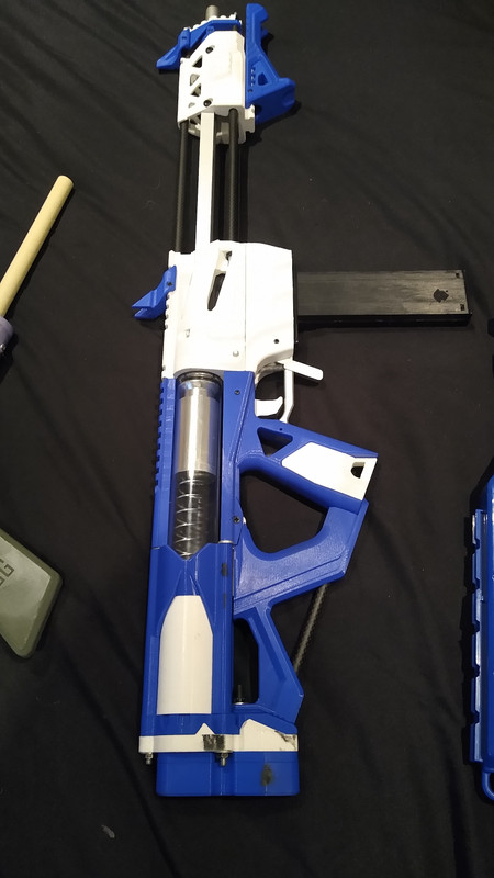

Sorry if the nerditry bores you, but I thought it would break up the monotony of waiting for celebrities to die -Gary Rhodes, whodafunkit?- to see if anyone else is into the weirdness that is hobby level nerf modification. Here are a few of my more unusual items I have built/bought over the last couple of years. All of these fire Stefan nerf darts which are essentially .50 cal nerf darts cut in half with differing tips depending on the required effect, apart from the small electric semi auto pistol in the top left, which fires conventional full lengths out of a radial magazine.
https://i.postimg.cc/d33jTpfg/IMG-20191203-212222157.jpg
The furthest left is a Worker Hurricane, which is a small sidearm that is capable of firing 6 full length darts at around 110fps in a couple of seconds. standard it shoots around 90fps on a 3s lipo -11.1V- but it has Twill textured flywheels and an aluminium guide barrel that lift Fps by around 20 or so. Incidentally, this is about as hard as you would want someone to shoot a nerf dart at you from 10 foot or so against skin.
The next is another sidearm called a rainbow pistol. The handle is a 3d printed piece with a transparent PVC tube containing the spring and plunger rod assembly. The name is derived from the style of catch it has, a rainbow shaped latch that can withstand huge loads. Originally it would have shot a Stefan around 200fps, which is not too shabby but I have modified this one with a 20kg Worker spring and an enhanced air seal which means it's FPS is closer to 300 these days. A hard tipped stefan dart will blow through a can like it isn't there at these velocities, as they weigh 1.5g which is around .6 of a gram heavier than a roughly standard 14 grain .22 rifle pellet.

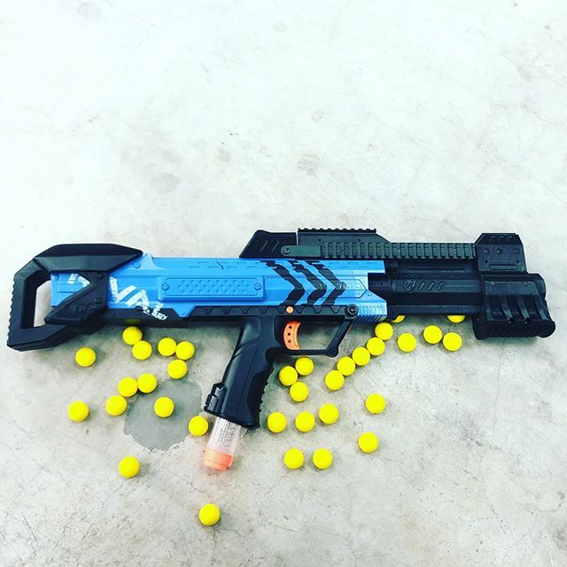

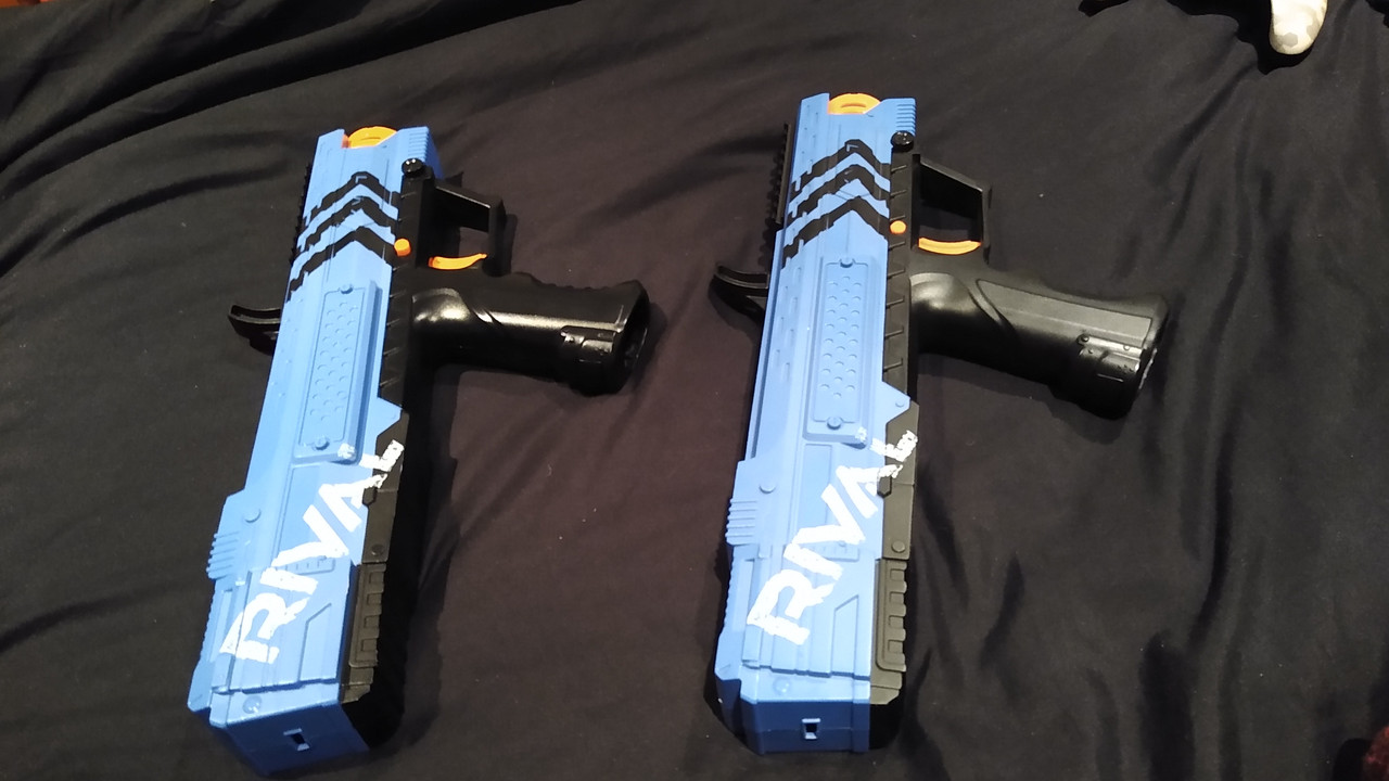

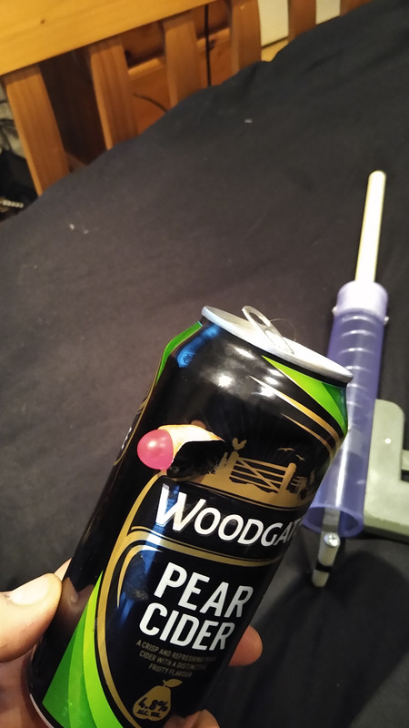

https://i.postimg.cc/7Y3sg8tT/IMG-20191203-213320047.jpg
https://i.postimg.cc/L84TLqZr/IMG-20191203-213326912.jpg
https://youtu.be/7oapk7Lxsak
I have included a pic or two of what I mean. And a video of what shooting a can from relatively point blank does. The bluntness of the tip of the nerf dart does impede penetration, but if a hard tipped dart is used, it will obliterate a thin skinned metallic object. the only thing that stopped this dart is the hardwood bed frame...

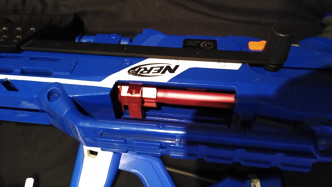

The next is my first build and my favourite nerf gun. This is a longshot rifle, first released many years ago and with an oddly oversized plunger tube for the intended purpose. Modders jumped on it and it all went haywire with 400 fps builds appearing all over the place. Mine is pretty much maxed out, with an Artefact hunter Stefan kit, enlarged plunger tube, 100 percent air seal, 34kg of spring -that's 75lb of force required to prime - a pump grip kit, a 400mm tight fit barrel and a continuous ability to break itself. I have never managed to get it on to a chrono but it would not surprise me if this could fire a hard tipped stefan at over 400fps. It's internals are all metal, there is not a single piece of plastic inside it. In the bed pic you can see the barrel attachment on it, this is an actual ported, rifled choke which was sourced from Australia, and is like you would get on a shotgun or similar. The effect it has on accuracy is vast, it can hit a can or similar size target from around 100ft which is outrageous for a high powered nerf gun.
https://i.postimg.cc/nrrsnQSt/IMG-20191203-212242391.jpg
Last on the bed is a Longshot rifle, which is essentially a reverse plunger gun with a direct plunger kit installed. There was a quite a bit of modification required to fit this kit and it's still a bit janky. It fires however, and I have bumped the spring by about 10kg and fitted a longer barrel made from 13mm ID Aluminium tube, taking it's fps from around 120 to closer to 180, but there is still a lot of work to do before I'm happy.

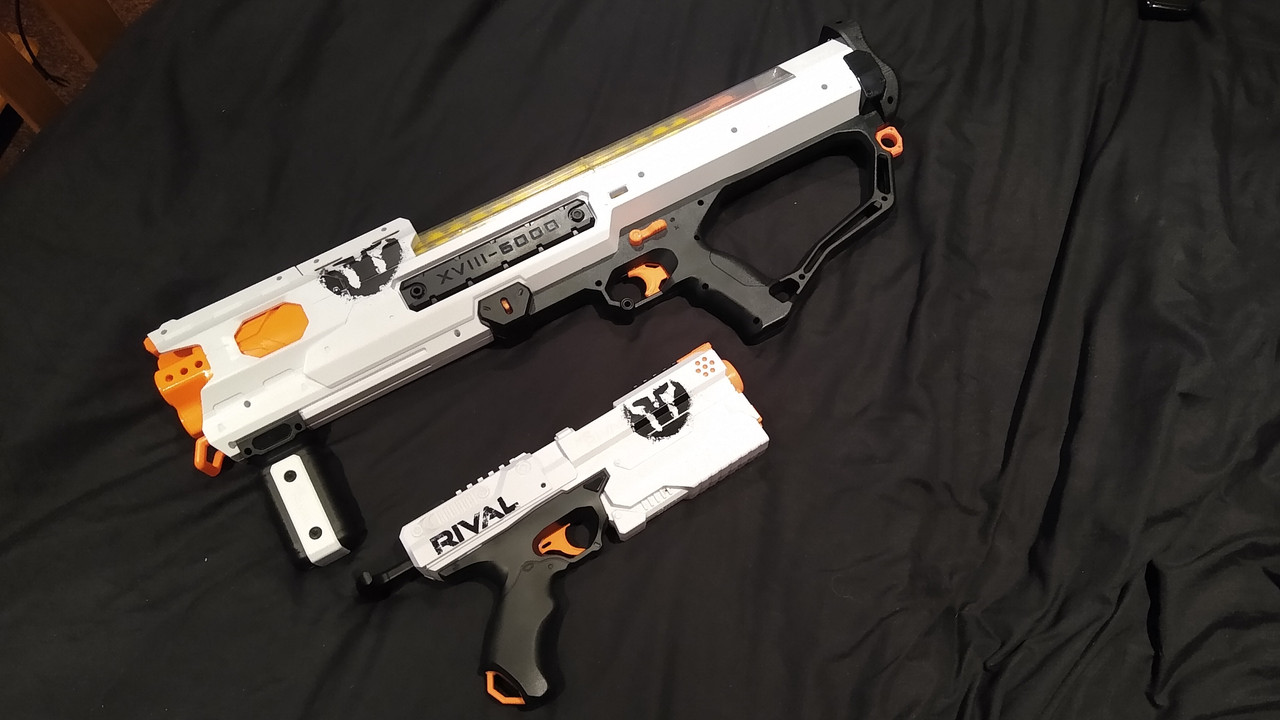

And pictured here with it's big brother, the Hades. These are on offer in the entertainer at the moment for 35 quid, which is really cheap considering a 50 pack of rival ammo is about 20 quid on it's own, and this comes with 60 and a massive hunk of plastic gun. Laughing they hit about 100fps stock. The Kronos is more like 85 stock.
https://i.postimg.cc/QChJHWD9/IMG-20191205-025047484.jpg
P.s the Hades is fucking massive. The Kronos is a hand cannon as it is, this picture doesn't really show it but the Hades is about 80cm long. Laughing

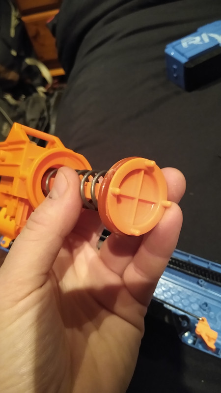

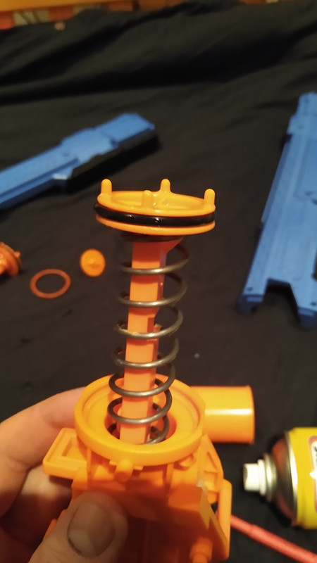

I'm bored and ill, so decided to sort out my modded Rival Apollo which had a flid about a month ago whilst I was shooting some mates with similarly modded guns.
The apollo is a rival springer which fires the ball type ammo. they hit 100fps stock, but this one is closer to 160fps due to a heavier spring, removed air restrictor -A/R for short- and boosted plunger seal which I suspected to be the cause. I also ballsed up when modding it and damaged the mount for the A/R which also has the job of stopping the gun from vacuum loading rounds back into the plunger itself. I picked up another spare as part of a package deal with two other, rarer rival blasters.
https://i.postimg.cc/QCdpx7DW/IMG-20191210-170451824.jpg

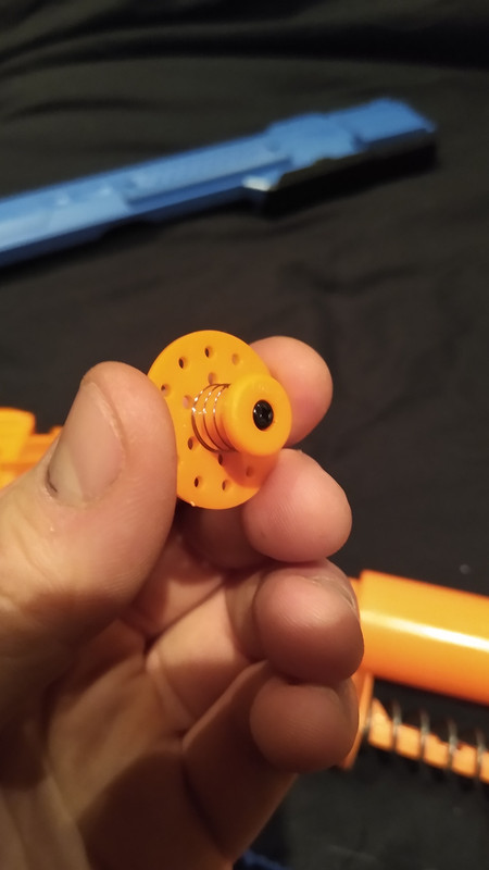

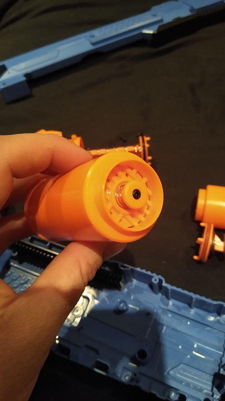

The modding communty has a love hate relationship with the Apollo, it makes big power and has a large plunger tube, with a handle mounted mag, but it's prime is janky and the hook on the top is extremely uncomfortable to prime with on higher spring loads. It primes through a gearbox to provide mechanical advantage but even like that it's a struggle with much more than an 18kg spring.
https://i.postimg.cc/8C1pJmFc/IMG-20191210-171135486.jpg

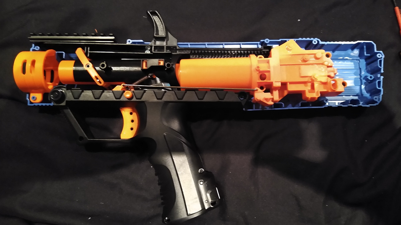

Inside, the modded one looks very much like the standard one, most of the changes are made within the plunger tube and the gearbox itself. All the mechanical locks are removed which prevent de-priming the blaster, repeat priming the blaster and multiple loading. This makes operation of the blaster smoother and also gives the ability to 'shotgun' the rounds, firing up to 3 with one trigger pull quite effectively.

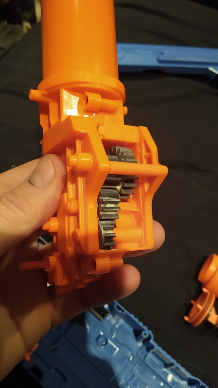

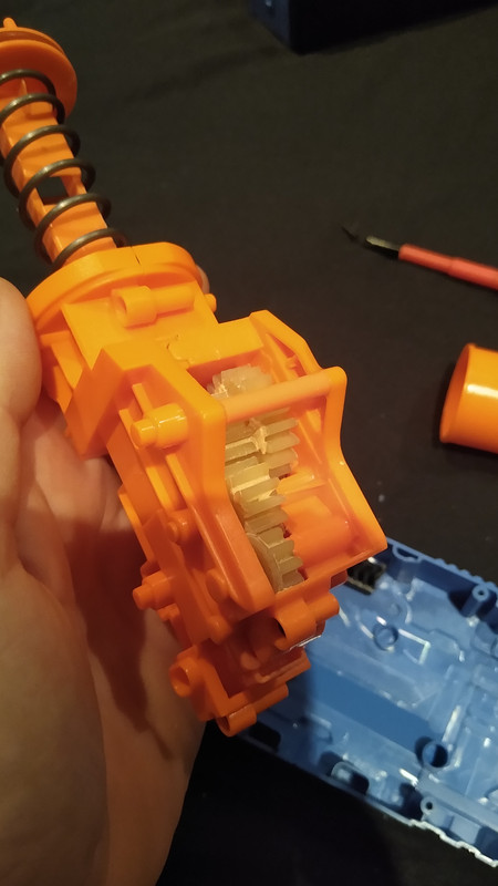

The gearbox and plunger tube is a bolted together unit, which is a nightmare to separate as it also relies on delicate plastic clips. I have already been in this one and have no intention of opening the other one unless I absolutely have to.
https://i.postimg.cc/GhpdCxBx/IMG-20191210-171403469.jpg
With the plunger tube removed you can see the upgrade o-ring has herniated causing the o-ring to jam against the tube and the resulting lack of seal is what is stopping the blaster from firing properly.
https://i.postimg.cc/2SM06r0S/IMG-20191210-171431377.jpg
Quick check on the gearbox to see the teeth aren't experiencing excessive wear. Regreased with white lithium grease.
https://i.postimg.cc/XYCz9rGC/IMG-20191210-171445742.jpg
Found a new o-ring from the parts tray and it gets a shot of silicone lube. Just like in all types of air and firearms, even nerf guns appreciate correct maintenance and lubrication. Seals and gearboxes going dry is pretty much why all nerf guns fail in the end.

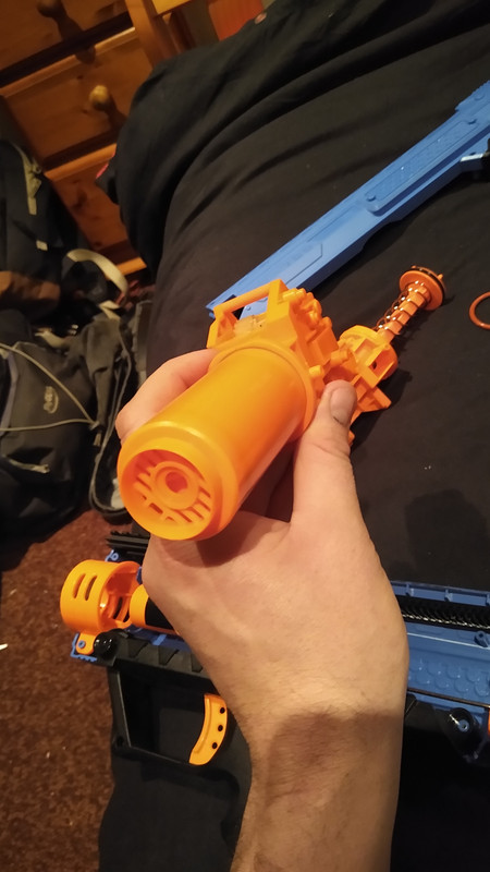

Tearing into the stock gun and pulling the tube/gearbox assembly you can see the standard A/R in there. Essentially it's a small, spring loaded plate designed to stop children -or irresponsible adults- dry firing the gun, smashing the plunger head into the front of the tube and damaging it. Only problem with this system is that when looking for extra power it represents a major hindrance to the air flow coming out of the plunger tube and therefore lower FPS. And we don't want that. I failed to get a picture of it, but the present plunger tube has nothing in the front of it at all, after I slipped with the screwdriver and punched through the structure of the plunger tube nose when removing the orignal A/R. Taking more care this time, the tiny, cheese like screw is removed and the A/R simply falls out giving us a nice straight shot through the plunger tube.
https://i.postimg.cc/1zK9Gmfy/IMG-20191210-171950486.jpg
https://i.postimg.cc/sfkMm2Tr/IMG-20191210-172046531.jpg
https://i.postimg.cc/fRh0zbdK/IMG-20191210-172512162.jpg

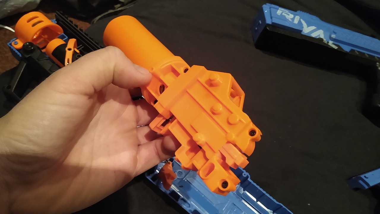

When having a look at the stocker, I found something interesting. The gearbox has a metal rather than nylon gearset in it, whether this is a later or earlier model I don't know, but it is handy to know I have a metal spare should this one let go. It's also an indication of how much force even these stock nerf guns are under trying to propel this relatively heavy ammo at even 100fps.
