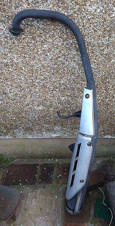

Hello guys any advice on a rusty exhaust please? Wondering is there a pipe inside the downpipe from the engine because where it has rusted away it looks like there is? I don’t really want to change Exhaust myself For fear of header bolts snapping and taking to a garage just now would cost a bit much.
I’m thinking something like fiberfix heatwrap could patch it up? Doesn’t seem to be leaking much if anything yet hopefully I can fix it up before it does, cheers Neil 👍https://i.ibb.co/Mpnf1Ct/D78607-B8-F965-49-EA-9-AF6-2-CD873749-E04.jpg https://i.ibb.co/zhPqJSZ/D931-FC88-F08-C-49-E9-AB52-1-E1-BC8-EB5-D64.jpg https://i.ibb.co/SckrbQX/F30-DD9-D1-BFF4-40-DE-B460-EEAC7-AEF0-D3-F.jpg https://i.ibb.co/86nQZ05/A5-FAC16-B-FB13-46-D4-88-D8-CD8-CAC88526-A.jpg

It looks to me as though the pipe is coated in a very thick layer of rust which is starting to flake off.
When's the MOT due?

Is that the original exhaust, and what year is it? Thats horrendous Laughing
I'd be wanting rid of that pronto. I dread to think what the header bolts are like, I'd be giving them a daily soak in plusgas or similar for a week then have a go at them, after getting the engine up to working temperature.

I offered up a decent one for £35 on Local Gumtree recently
not gone yet

It came off a 2010 EFI,exactly the same model as yours
I told my mate it was sound but slightly rusty and so I cleaned it up
and sprayed it with VHT paint.
A couple of months later he phoned and told me it was blowing and asked me to order a new one.
When he turned up the exhaust was fine he'd just been riding about
with the bolts in the head getting looser and looser until they eventually dropped out!
He knew one had gone at one stage but didn't mention it
Daft clueless sod he is.

Looks like it is double sleeved.
Some Hondas are like that. I normally leave mine until they look like the OP's before changing, too! Laughing Cool

A set of Lock-On sockets on an impact gun may help with removal, but suppose you could try wiggle them backwards and forwards very slowly with them attached to a ratchet.
Alongside plus gas this may help.
Remember to get a new exhaust gasket ring (small circular gasket that fits in the engine behind the exhaust plate that attaches to the engine).

Will be posting the one I have here to him this week.
and will bung in a gasket and wee drop o the old copperslip
The biggest snag as we know is getting the old bolts out
Hope they come out with minimum faff
Once they're out, the rest is easy.

The usual, I suppose. Go for a run, heat it further while still hot, and be careful. There must be a hundred how-to and sob-story threads by now.
