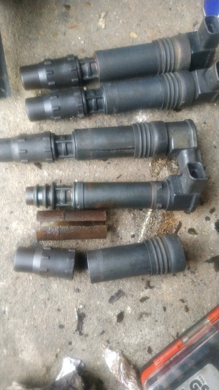

kramdra
Joined: 28 Oct 2010
PostPosted: 01:47 - 03 May 2020    Post subject: Reply with quote
Nothing wrong with those in pic. Look the same as mine Denso branded. They seem to have a thin rusty steel shim and thin plastic wrapping, but if you unwrap, the plastic casing underneath will be fine. I have had mine unwrapped for about 40k miles. Keep as spare or stick on ebay.
As I had mine out... One had already rusted and split, another I took the steel shim out today and the other two are as standard.
Im quite sure the steel shim is just a spacer to help seal the rocker cover plug bores and have been running mine without since 2016.
https://i.postimg.cc/MK62HG5Y/IMG-20200503-193450.jpg
