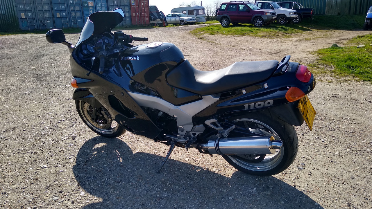

Given a recent run of luck, mainly related to finding good bikes at bugger all cash, such as this 16,500 mile ZZR1100 for 500 queenheads:
https://i.postimg.cc/KcLbYCDf/IMG-20200322-135703884-HDR.jpg
Notice the standard post respray 'KAWASAK' moniker on the tank. The 'I' always falls off. Laughing

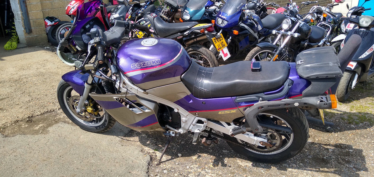

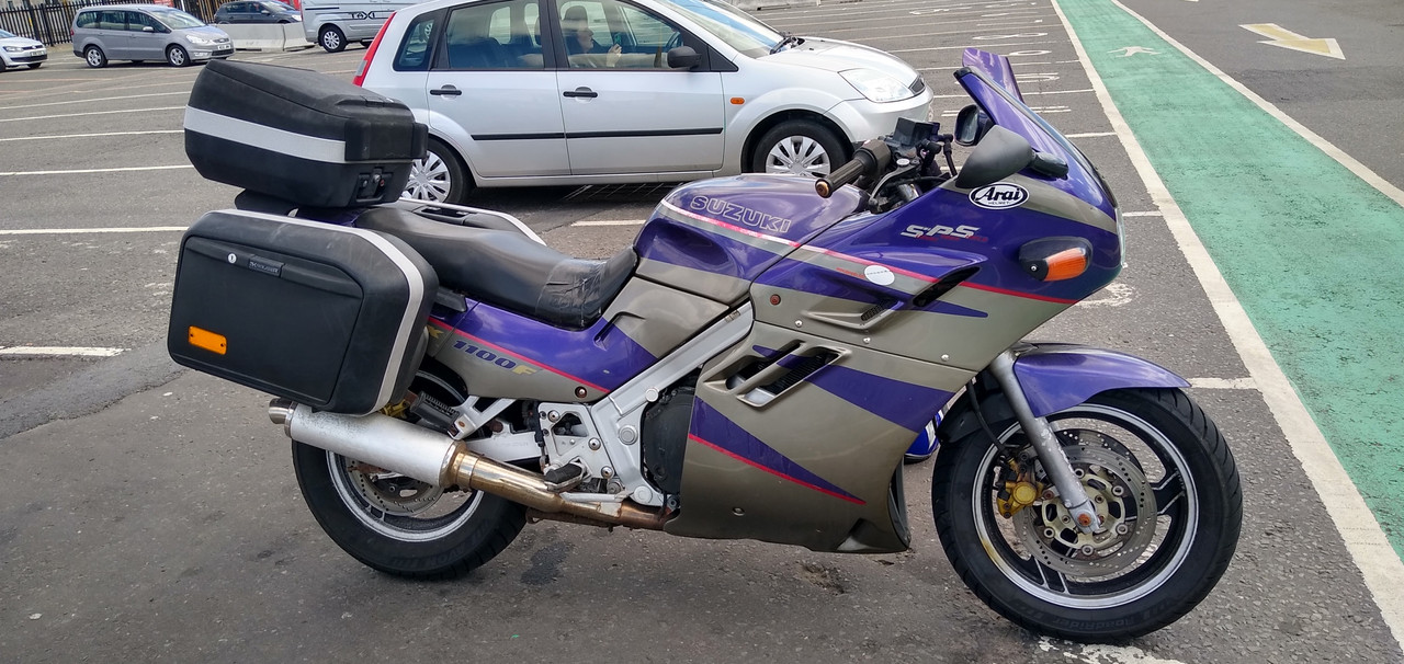

Known issues are the SPS don't work [like most of them TBH], it has a blown fork seal, stopped starting on the button and the ignition is a screwdriver jobby after some scrotes tried to nick it a year ago. However it has MOT till september, runs great and is rideable.
I handed over the asking price and then went to see it. Why would I hand over the asking and then go to see it? This motherfucker only set me back 150 quid. 150 greenqueens. That's less than a decent pre-covid night out, and this big girl likes to party all-the-time.
https://i.postimg.cc/yddSCcgJ/IMG-20200502-134451709-HDR.jpg
I bump started it in front of the bloke, however when I got to the ferry terminal I had a spare few minutes so I pulled the sidestand switch wires out and wound them together so it started on the button.

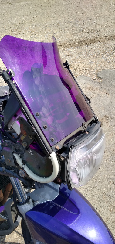

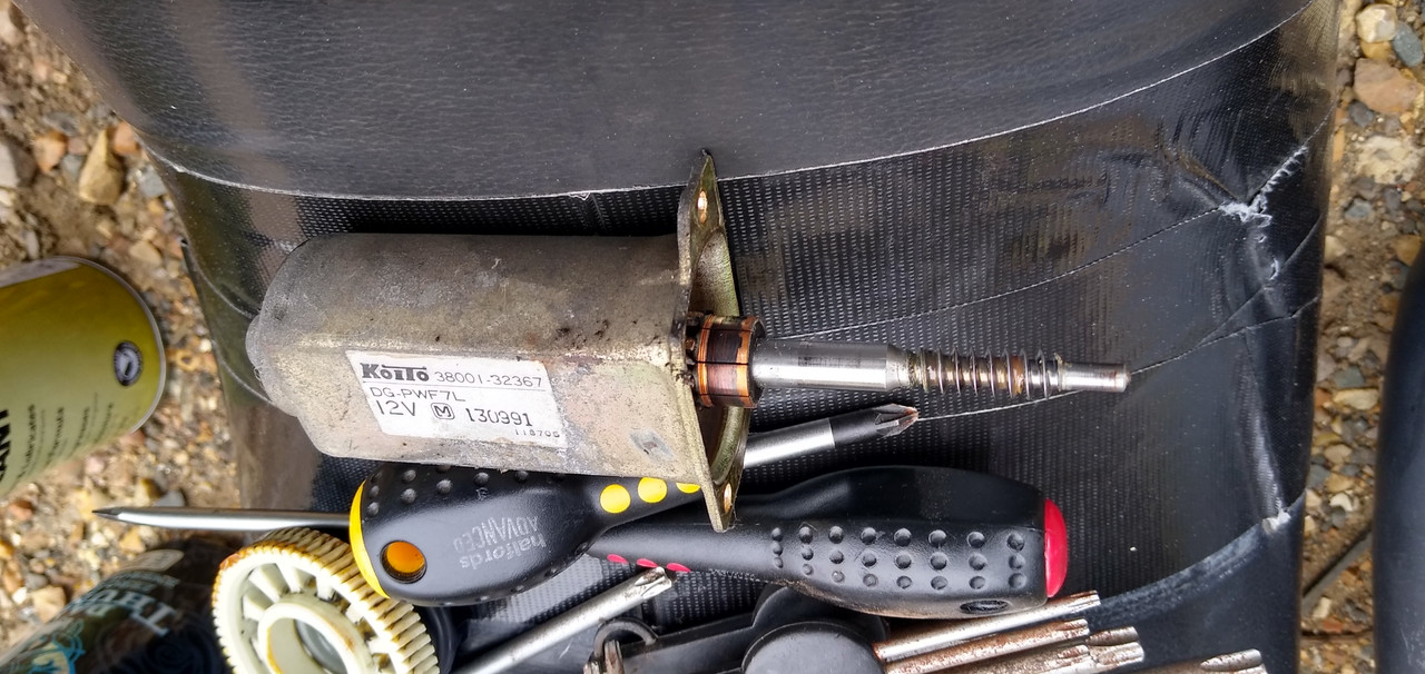

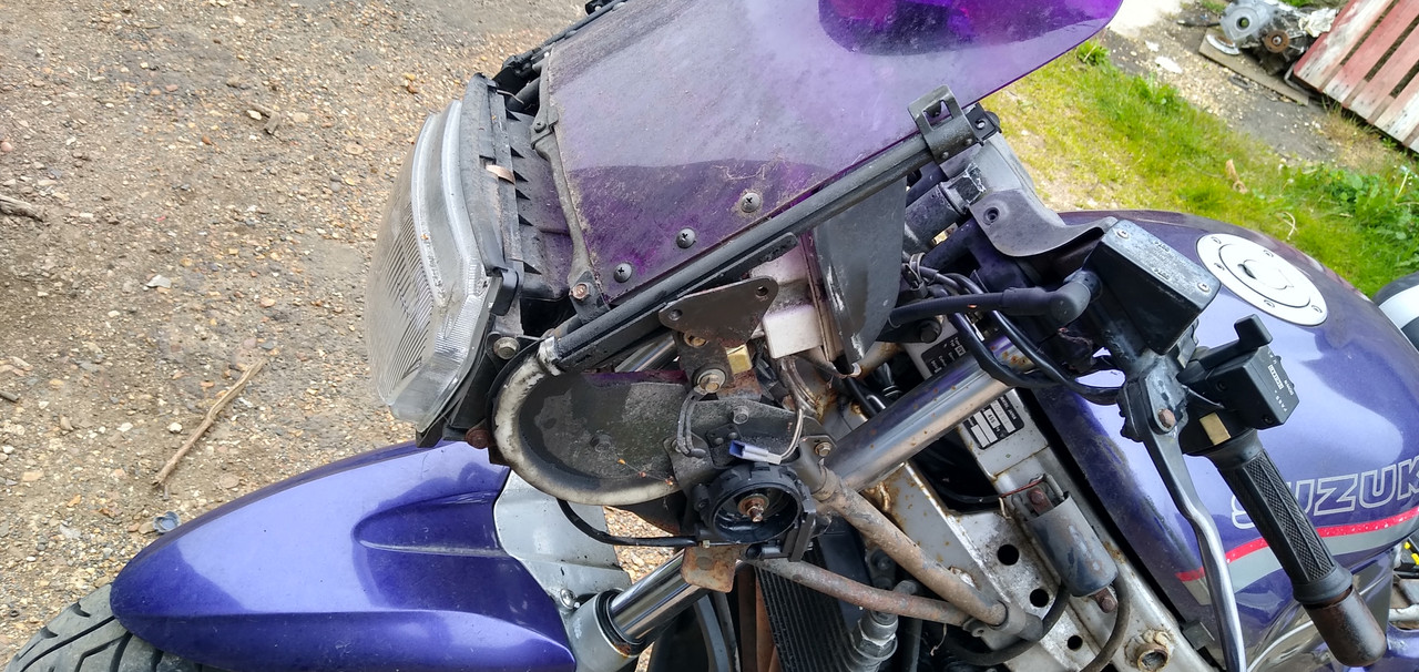

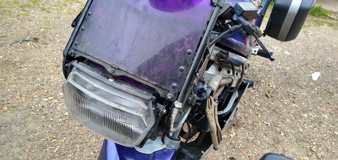

Getting it back home [cracking ride, brakes are covered in oil so it didn't stop, but the standard one doesn't anyway] I had the face off straight away. The SPS [suzuki power screen] had to work. According to the bloke selling it it hadn't worked for about 12 years [he'd owned it ten and his old man sold it to him cheap, it didn't work then] so regardless of what stopped the screen working in the first place the mechanism was proper seized. like 4hrs of painstakingly removing the motor, gear drive, working lube into tight spaces[ Razz ], tweaking the screen, rinse, repeat 4 hrs seized.
https://i.postimg.cc/8CmDTYQc/IMG-20200503-123731190-HDR.jpg
https://i.postimg.cc/c4tvddDJ/IMG-20200503-123740074-HDR.jpg

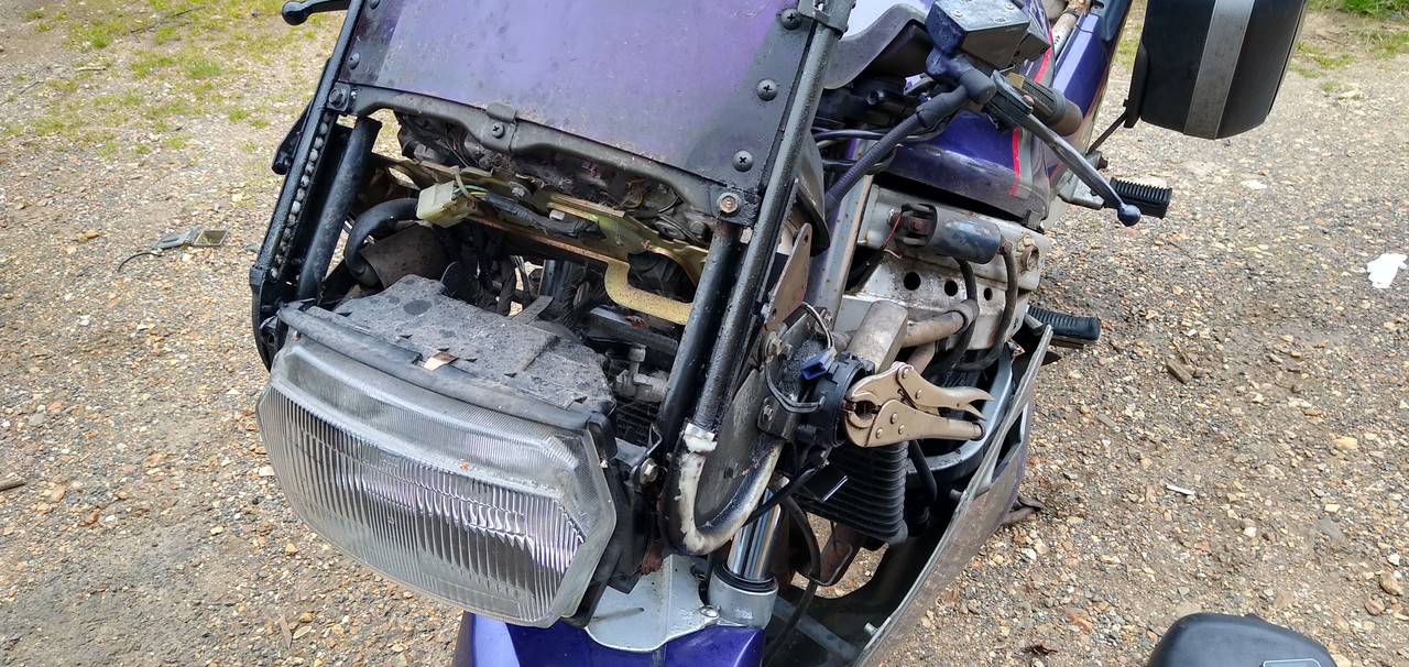

Motor looks in great nick, hardly used, so I just cleaned the comm and brushes and shoved it back in.
https://i.postimg.cc/GtdnVJSY/IMG-20200503-124042106.jpg
https://i.postimg.cc/QNf89C4b/IMG-20200503-131645124-HDR.jpg
With a set of molegrips clamped on the drive spigot I was able to lift and lower the screen 1mm at a time until I'd covered the whole travel.
https://i.postimg.cc/QxRwzZY5/IMG-20200503-131637364-HDR.jpg
Once it had travelled the whole range of moevement smoothly with little resistance I reassembled the gear drive and motor, pulled the motor connector and manually jumped it with wires off the battery.
https://youtu.be/lq-j4HTTRLA
Poggers.
The original failure was on the part of the relay that controls the screen. the wiring pings fine, as does the handlebar switch. The mechanism now works perfectly, we are left with the relay, that rattles when you shake it. I have ordered another so hopefully that will get us a screen moving on the button.

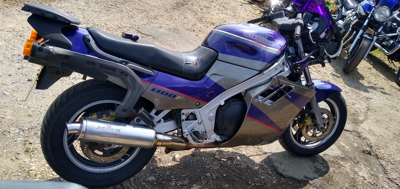

Got around to degunking it a fair bit.

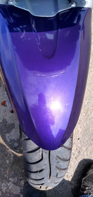

Paint, where it hasn't been rubbed off by boots/legs/cover over the years is still in good nick, even with an ever so quick polish.

Can was also horrible, to the point the metal had discoloured as well as pitted. 15 minutes with autosol and a scourer got it back to 'fuck it I'll smoke that about' status.
https://i.postimg.cc/90fb70qn/IMG-20200504-131708681-HDR.jpg
It really needs going over to replace all the bolts and fastenings as they are horrible. something I will be doing one by one when it is back together.
