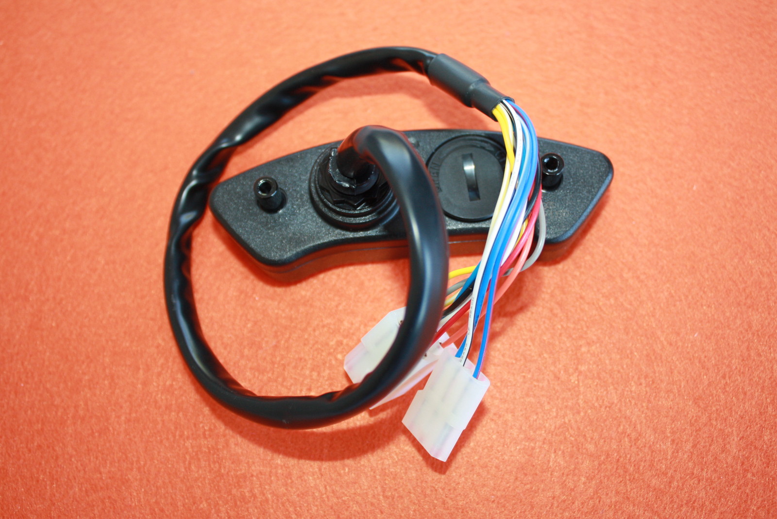

I'm looking at the pictures of speedos for that sort of bike...
You'll probably have to take the speedo off but if you flip it over does it have a circular panel next to where the cable goes in?
Like this one on eBay:
https://i.ebayimg.com/images/g/sggAAOSwfZhXM0g4/s-l1600.jpg
https://www.ebay.co.uk/itm/Tacho-Instrumenteneinheit-Rieju-MRT50-Marthon125-MRT125-MRT50/323890410957
If so get a 2 pence piece or similar and it should open up revealing a calculator-style lithium battery. Probably a CR2025 or CR2032.

Easy-X you are a star, sometimes the most obvious things seem to be invisible. Whipped the headlight off to gain access and sure enough a CR2032 battery compartment.
