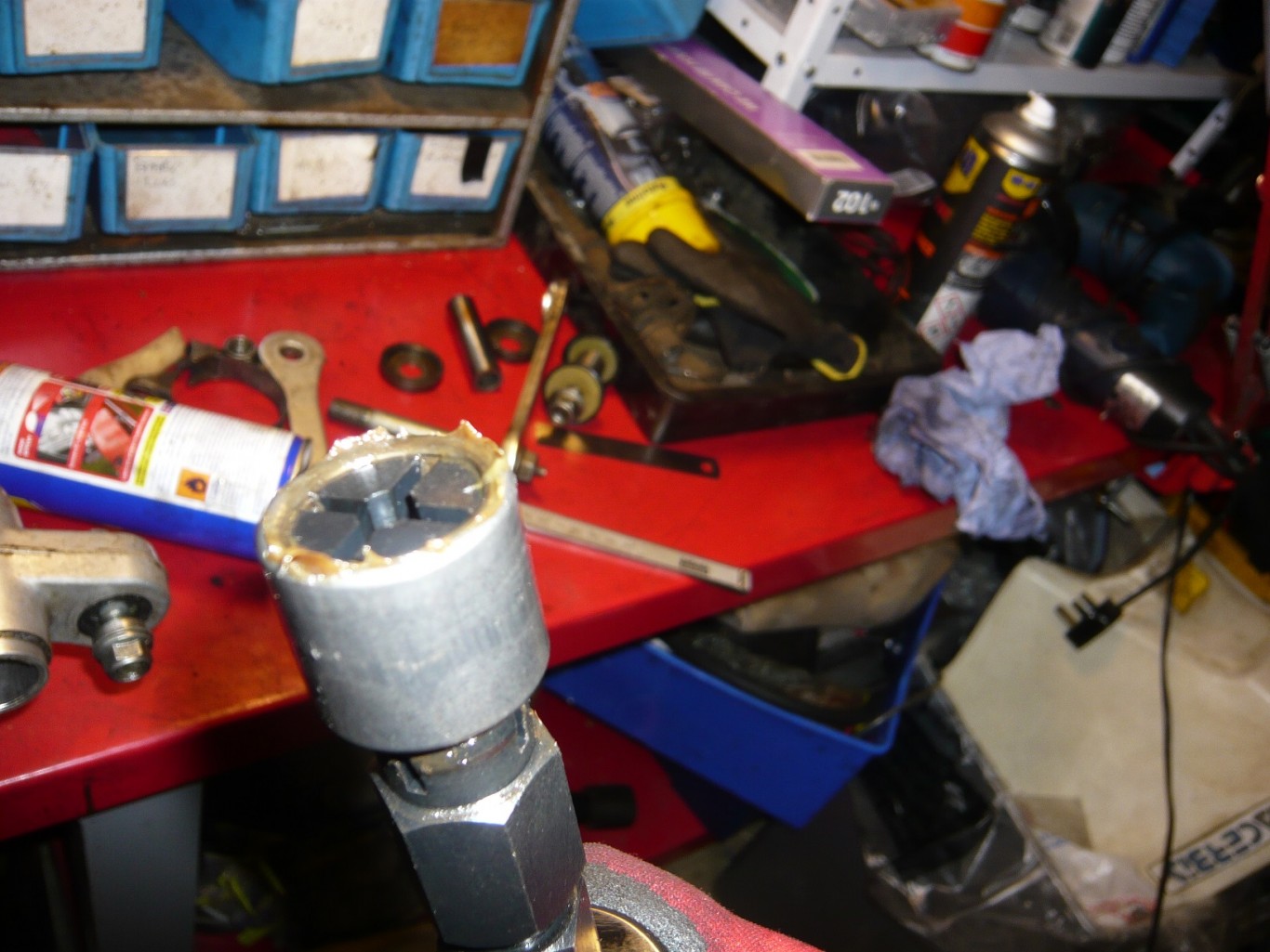

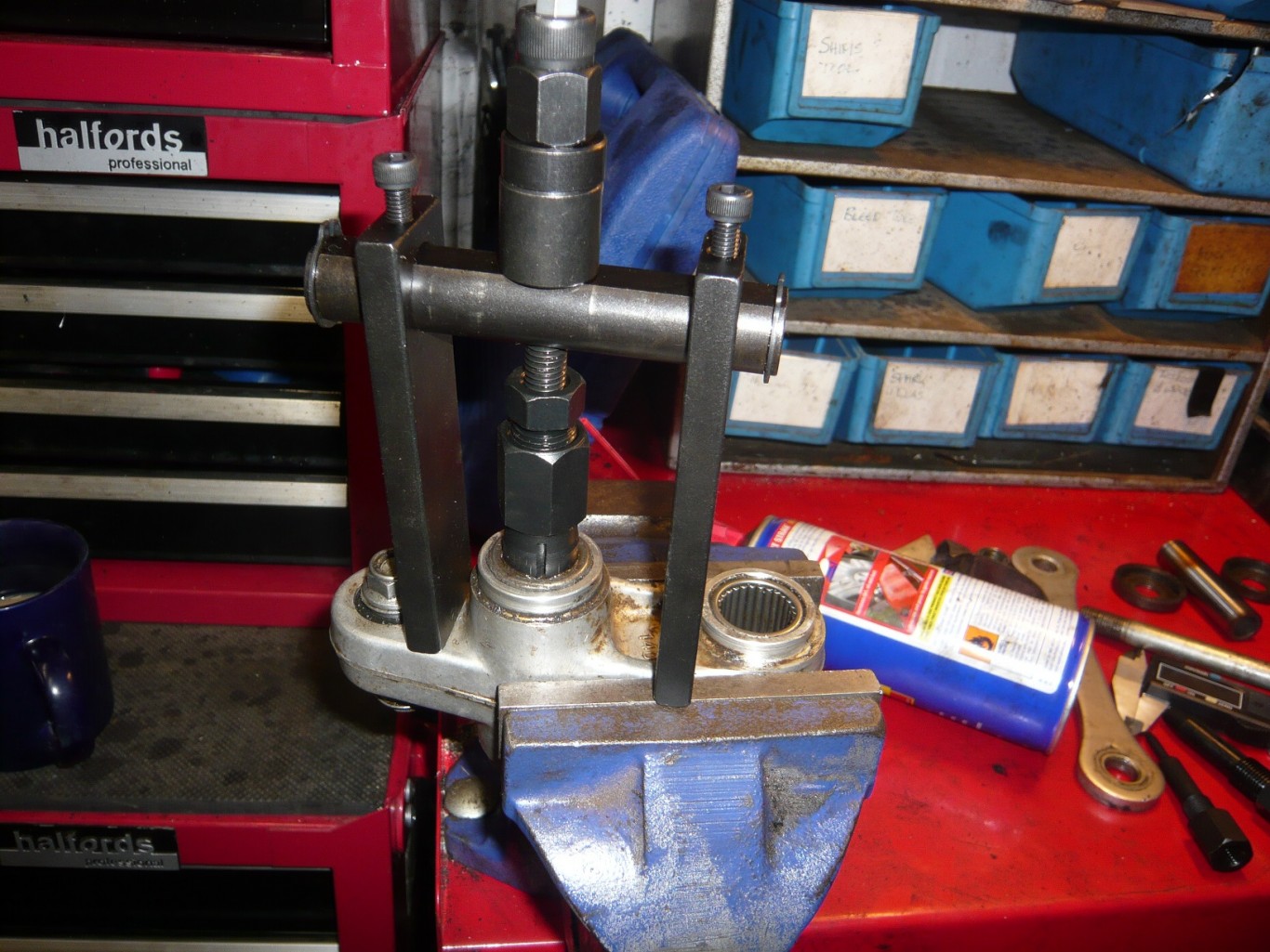

Just done this on my old DR350. I started off using my bench vice with various sockets to push some bearings in or out, threaded rod and washers were used as well until the rod thread gave up the ghost.
For a particularly evil set in the swing arm I bought a proper blind bearing extractor set with the money I'd saved from not riding to work for 8 weeks. It had a slide hammer and one of those bridge extractor thingies. Watching a bearing come out at 0.02 mph is very soothing, especially with mood lighting and sexy music.
https://images.versys1000.com/bearing-just-starting-to-move.jpg
https://images.versys1000.com/old-bearing-on-extractor.jpg
https://images.versys1000.com/old-bearing-quarter-way-out.jpg
