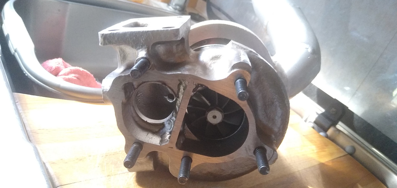

Bandit has been down on power recently, been stripped down and here's what I found.

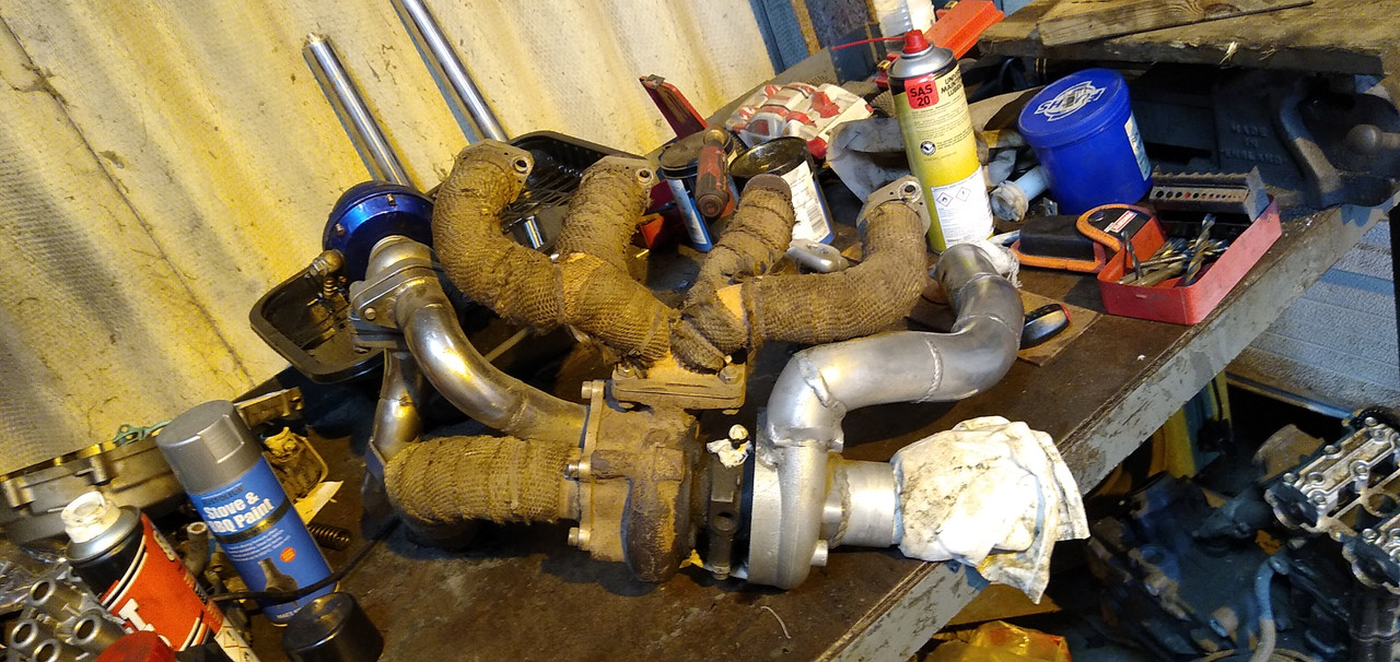

Turbo off:
https://i.postimg.cc/GhzBhZQz/IMG-20200427-125008689.jpg
Oopsie.
https://i.postimg.cc/yNhC7zh8/IMG-20200429-123920561.jpg

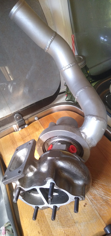

Back from Midlands Turbo, new bearings, seals, compressor wheel and blasted housings.

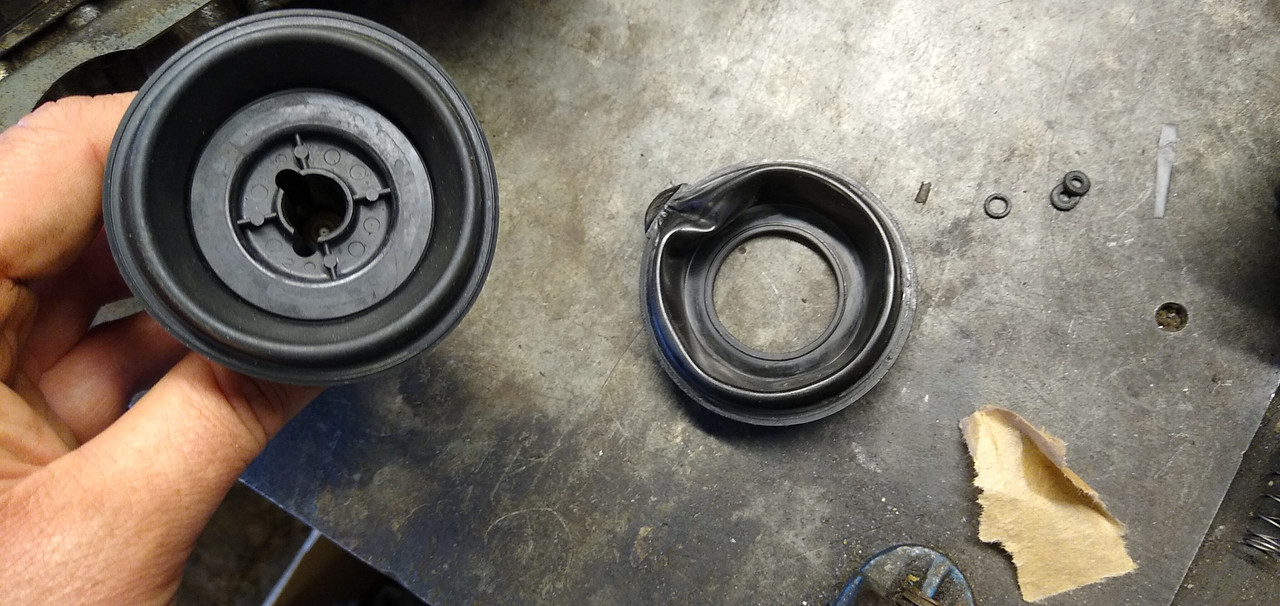

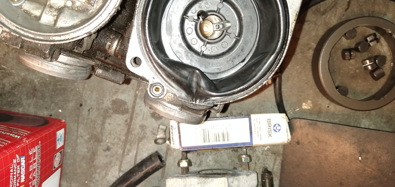

Bike also had a running problem at idle and low speed, When I removed the carbs I found this:
https://i.postimg.cc/BvNsx0jw/IMG-20200427-131709775.jpg
Plastic caps have given way under boost, pushing a slider diaphragm out and blowing two of the vacuum o-rings out from under the takeoffs.
https://i.postimg.cc/9f45q7jz/IMG-20200427-132625759.jpg

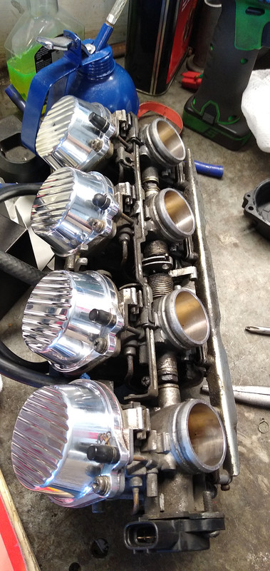

Easy fix with a new slider diaphragm and a few new o-rings... And a couple hundred quids worth of billet caps. Shocked
https://i.postimg.cc/hjpLWffb/IMG-20200504-142003870.jpg
https://i.postimg.cc/3JDv9LCZ/IMG-20200504-145617543.jpg

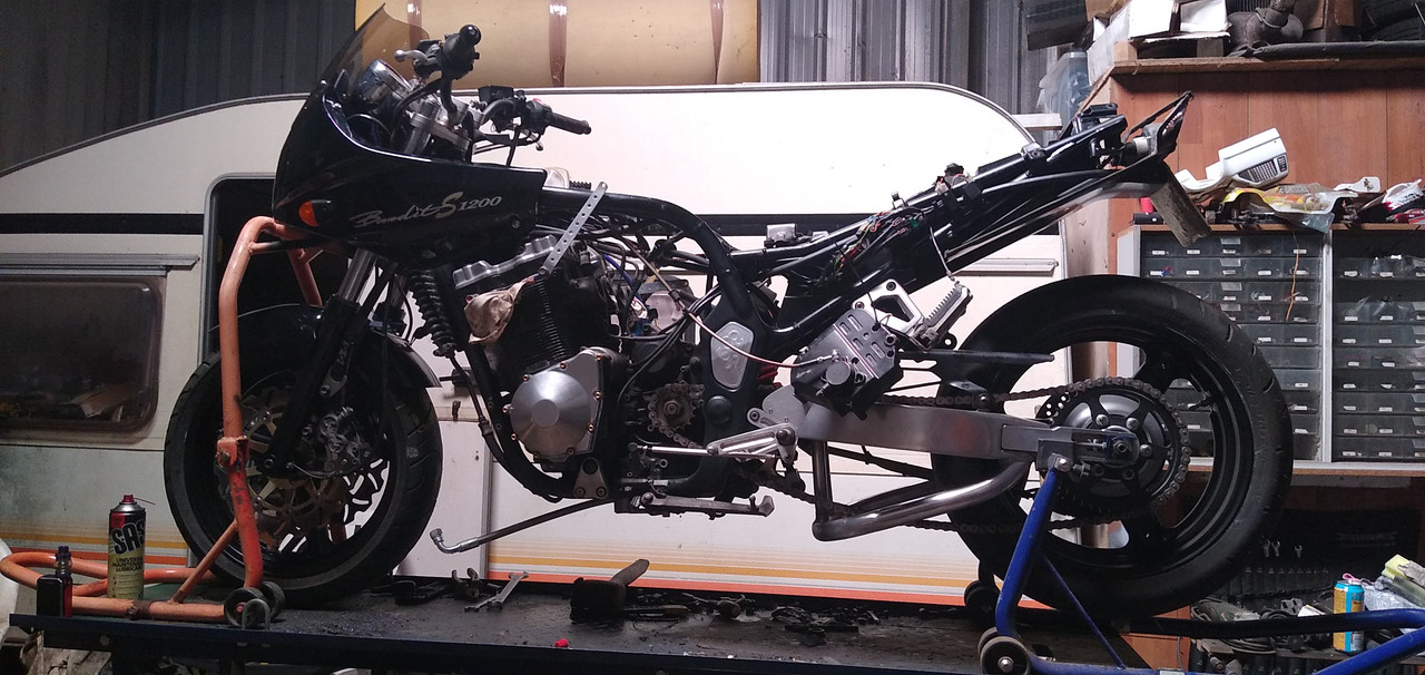

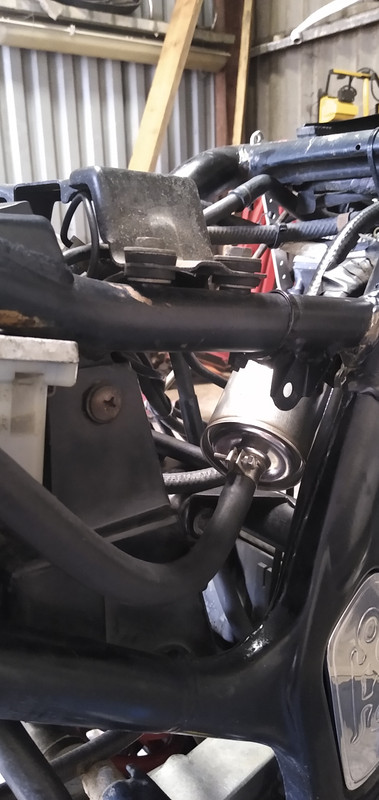

Bike is also receiving a new fuel system as a matter of course, so new pump, filter, governor and hosing. All vacuum hosing is also being replaced.
https://i.postimg.cc/nVqsDsHd/IMG-20200516-135145197.jpg

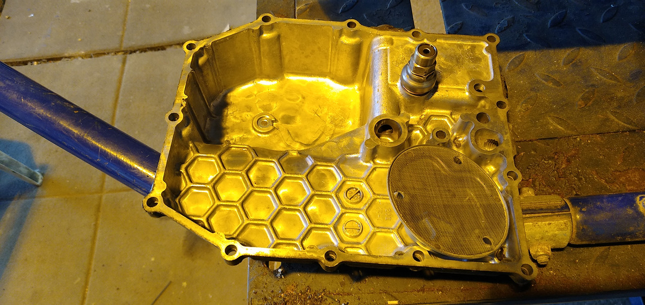

Sump off for a clean out in case the bearing material from the turbo made it back to the bike.
https://i.postimg.cc/0y453xkM/IMG-20200512-151917694.jpg
Also had new feed and return lines made up for it. Trying to give the rebuilt turbo a chance at life.

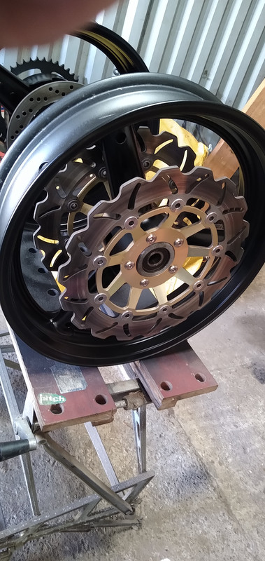

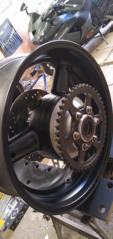

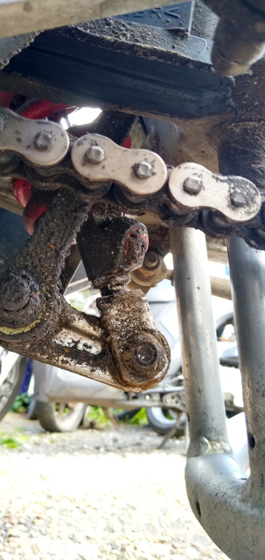

Chain and sprockets are knackered, which is a fairly big deal as the bike runs a drag spec chain. Picked up a Regina drag chain and a set of JT steel sprockets, the rear one in matte black for added moodiness. Finally made the wheels the same colour for the first time ever, satin blacked and discs refitted with new titanium bolts.

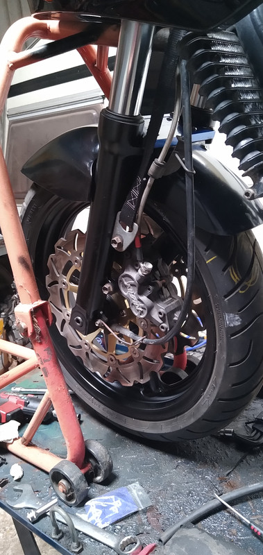

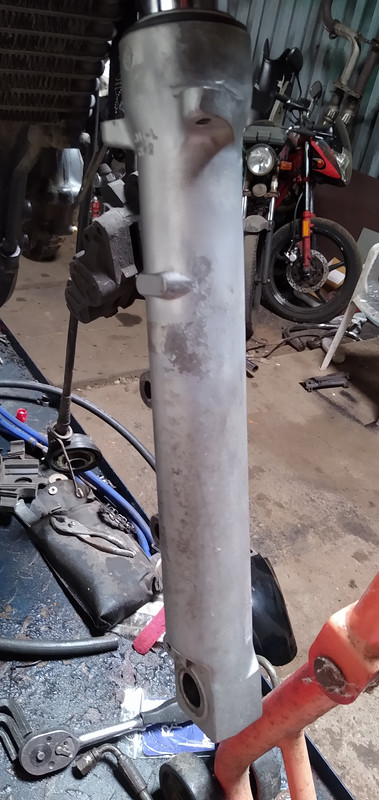

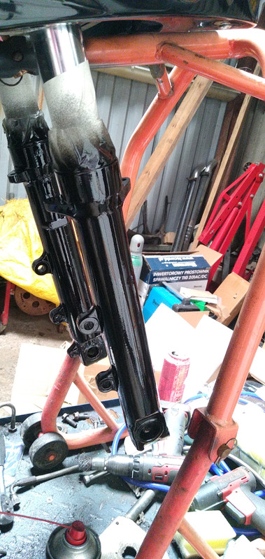

Forks have always been minging. Before I put the front wheel back in I rubbed them down and sprayed them black.
https://i.postimg.cc/vHNcR5XZ/IMG-20200523-124723962.jpg
https://i.postimg.cc/26KPjjth/IMG-20200523-131908467.jpg
https://i.postimg.cc/XqF3Tyvp/IMG-20200523-145353041.jpg
Bit better. New chain is gold so added tart when it goes on.

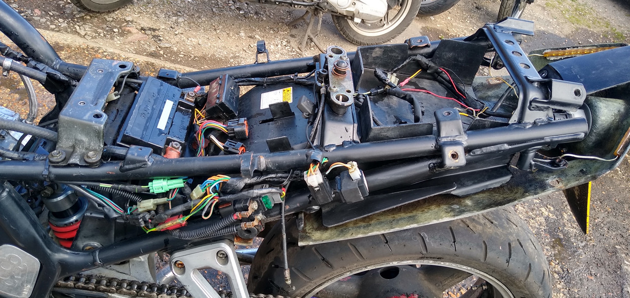

Forgot to say, I also cleaned it. A couple of before and after shots. This is a daily ridden bike, and it goes out rain or shine. Or snow.
