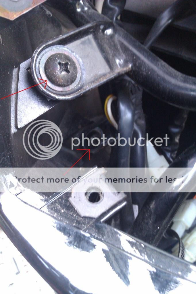

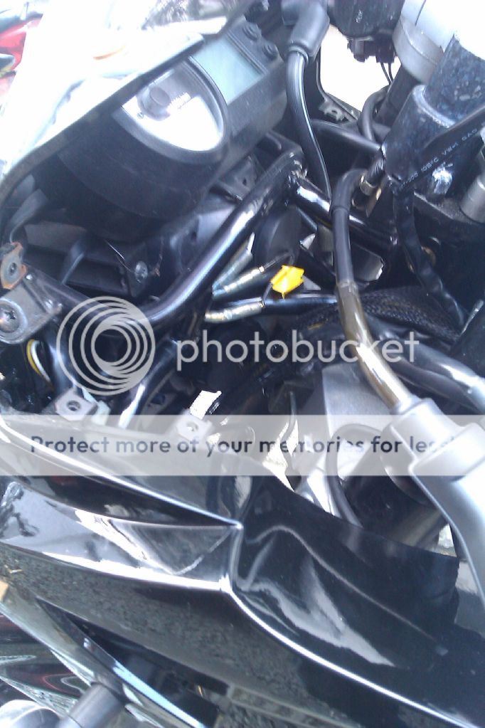

ok, so today i managed to get some time to have a look at the headlight.
i'm not sure its possible to change the bulbs in these headlights with the front fairing in place, so this is what i did, from what i can remember.
1. remove the 6 screws around the instrument panel and remove the panel.
2. remove the bottom bolts holding the front fairing in position (see bottom screw in pic below) leave top ones in but loosen.
3. remove all the screw holding the front fairing to the side fairing, 3 each side.
4. remove the nuts holding the indicators to the fairing frame
5. remove the allen bolts holding the mirrors in place.
6. remove the top 2 bolts holding the fairing in position (top ones in pic below)
7. remove the front fairing.
whilst i was at it i took the side fairings off, these will come off in one piece and can be wriggled out under the bike.
https://i1102.photobucket.com/albums/g458/Cheerfulgrin/bike%20pics/Hyo%20GT250R/IMAG1006fig.jpg
https://i1102.photobucket.com/albums/g458/Cheerfulgrin/bike%20pics/Hyo%20GT250R/IMAG1025.jpg

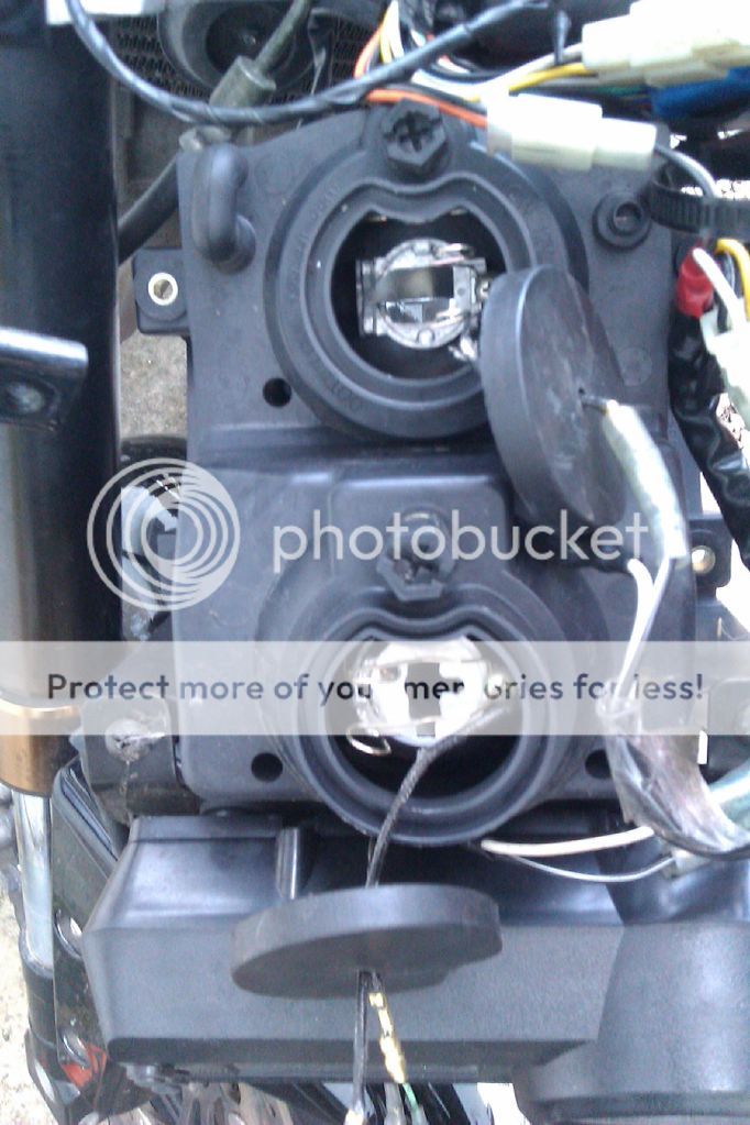

the lamp holders and the common wire spring mounted type, but there is little room for manouver.
https://i1102.photobucket.com/albums/g458/Cheerfulgrin/bike%20pics/Hyo%20GT250R/IMAG1019.jpg
there are more pictures from this job in this album so have a browse if you like.
the wiring all looked in good condition, although it needed tidying up, there is a rubber boot type thing that wraps around the connectors, so put some tape round that to be on safe side.
i've tested them and they now work, so pleased with that, just got to put the fairings back on tomorrow, time beat me today!
bulbs are 12v 55w H3 for dip lights
12v 55w H1 for main beam
you can get these in any car spares shop.
given the fairings a good clean, filthy inside and underneath, and touched up some small scuffs here and there, painted the allen head bolts for mirrors.
looking forward ot getting it back in one piece and out for a spin at weekend! Laughing

https://i1102.photobucket.com/albums/g458/Cheerfulgrin/bike%20pics/Hyo%20GT250R/IMAG1008.jpg
this picture gives some idea of how cramped it is, but i'll try and take a better one before fairing goes back on. i've read its possible with small long nose pliers and some patience. 16 screws to get the front fairing off for a headlamp bulb is a bit tedious!
its a bit neater back there now though so it might be easier if i have to do it again.
