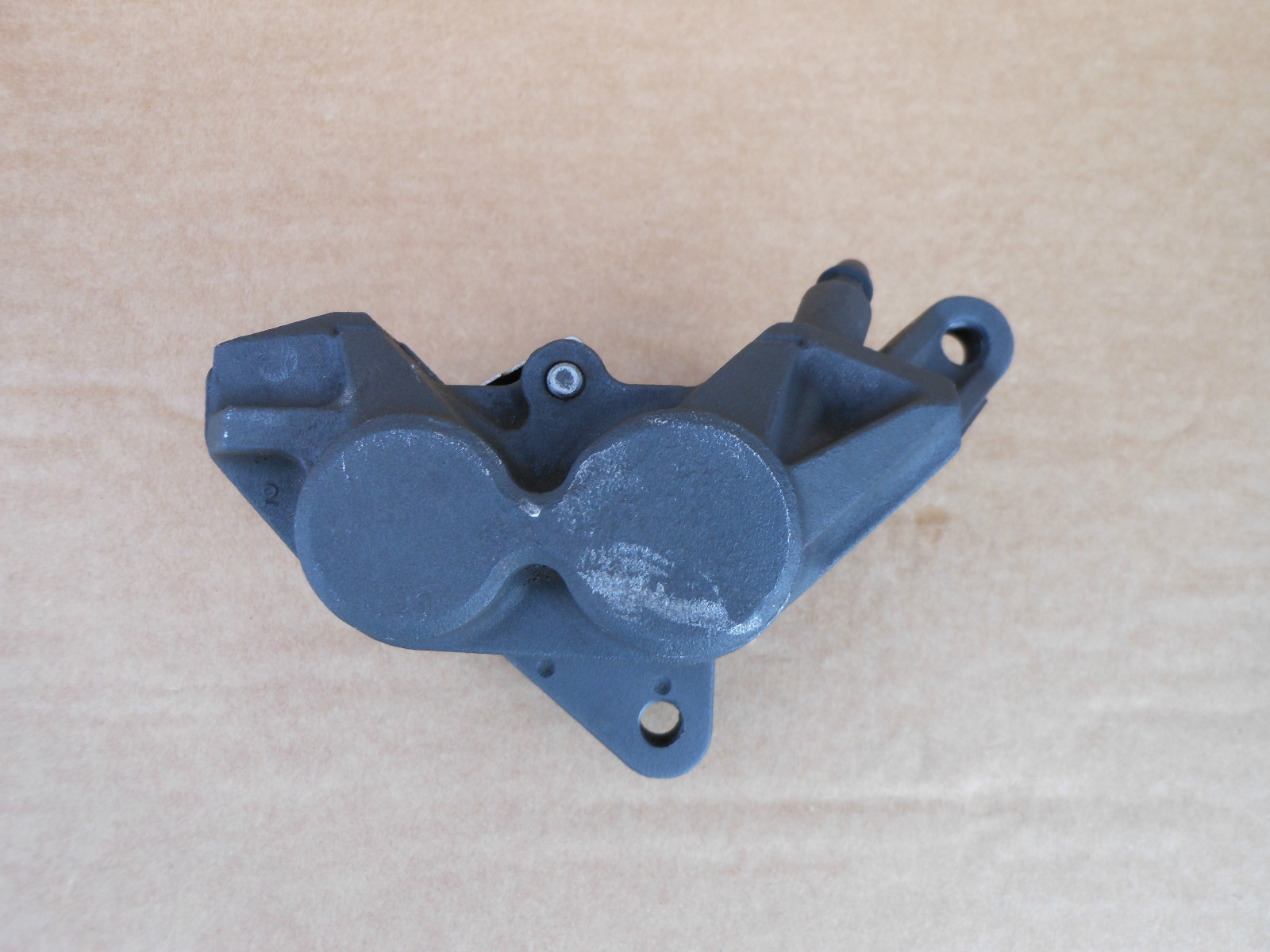

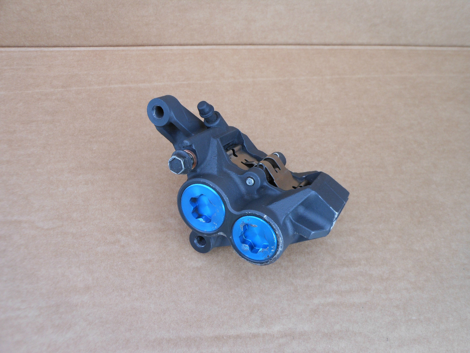

Probably be easier to figure out when I've got the bike, but looks to be that the rear can be split, but the front cannot.
https://i.ebayimg.com/images/g/38EAAOSwMgdX0EDJ/s-l1600.jpg
https://i.ebayimg.com/images/g/13cAAOSwi0RX0EDu/s-l1600.jpg
Worked on brakes before, but when I posted this I wasn't aware the rear could be split. As for the front I'll probably have to go with working on one side, bleed and re-do. Slow, and pain, but a far cry better than the million and one wires and bleed nipples on the CBF1000 with abs (long live simpler bikes Laughing ).

Front cant be split, but you can unscrew the 2 blue anodized caps with the tool, although obviously only helping with one side.
Various threads, and manual, says not to do this.
Would make life easier, but renders calipers useless and can damage them.. on what I read with my current knowledge.

That caliper is almost exactly the same as can be found on my FZR1000R and my FJ1200-3XW.The caliper half seal is not available from Yamaha but is from the likes of Wemoto and Powerhouse,as Kramdra has suggested.
As for removing the pistons from the monoblock front calipers,they are near enough the same as on my R1.It is easy enough to hold the pistons in one side while the other side is worked on.But the slide hammer removal type tool is useless on these 'Blue-Spots'.
I use an old master cylinder clamped to an old handlebar in a vice to work on calipers.
As for removing the 'Blue-Spots',the seals for those plugs are not readily available so it is not advisable to take them out.There is a tool on eblag but I have never needed to do this procedure and I have worked on many one piece calipers over the years.Have some red seal grease to hand on the rebuild (although this will bring on plenty of comments from some who try to suggest that it is not the right stuff to use,despite numerous magazine articles that say to use it).
Always have a 'Plan B'
Aye, now I realise that the rear can be spit it makes me panic less about ownership (the joys of under-slung calipers); and based on fronts I've worked on in the past it would take some serious neglect to make removing those blue spot cap things (forgot name, its late) as the fronts generally suffer way less than the rear does.
