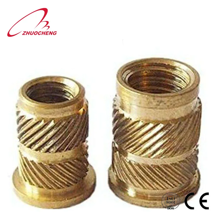

ABS stick/sheet, soldering iron. You can use brass captive nuts and melt them into whatever you want to fasten easily enough. They're very inexpensive things.
https://sc02.alicdn.com/kf/HTB1R0PMbifrK1RjSspbq6A4pFXaK/220932354/HTB1R0PMbifrK1RjSspbq6A4pFXaK.jpg
