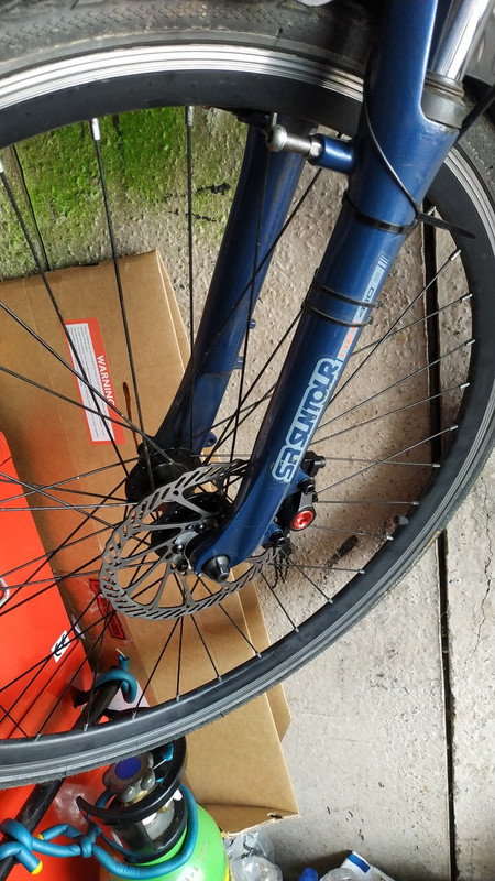

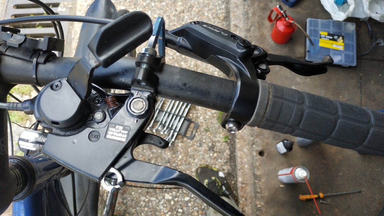

Got the front brake fitted today, not ridden yet I need to sort the gear lever.
https://i.postimg.cc/mrZS9FXg/IMG-20200702-150419.jpg
I assume the lever pin needs to be driven out with a punch?
https://i.postimg.cc/4x4b9gMv/IMG-20200702-140825.jpg
The v brake pivot pins have 9mm spanner flats but dont appear to budge. Looks threaded, probably locked and just needs some heat, but what is that 2.5mm hole behind it?
https://i.postimg.cc/5N4FPm3b/IMG-20200702-143640.jpg
Did 60km yesterday. I do need a narrower, less padded seat. Seats are expensive Shocked What is a decent, cheap seat?
PostPosted: 14:41 - 02 Jul 2020    Post subject: Reply with quote
The little hole is for the end of the return spring.
Some lever pins have a tiny little circlip inboard of the lever perch (between the lever and the perch).

Also measured for tyres. The rear lower tubes have clearance for 50mm, upper tubes 65mm.
Forks would be plenty of clearance but for the wheel being off 10mm off centre due to the disc hub, but it will fit 50mm.

Re-dish the wheel it so the rim is in the middle. Easy to do. If you want to move the rim to the right, you start at a marked point then work right round and tighten the right spokes a quarter turn and loosen the left spokes a quarter turn, then check your dish again. Rinse and repeat.

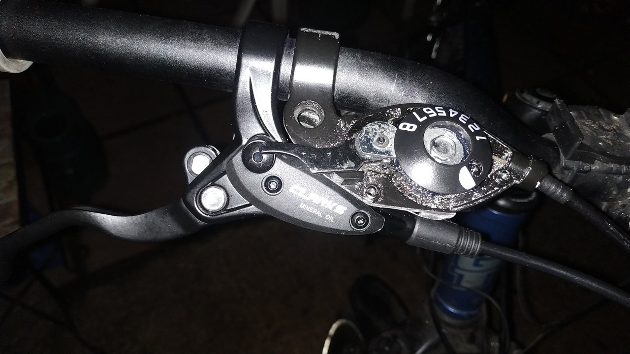

I did not realise how much fuckery would be involved. Almost done I will trim the plastic, new downshift handle and epoxy any new holes, not that the shifter bit was in anyway sealed to begin with. The original brake lever pin was a 2 peice rivet, if anyone wondering I drilled it out before cutting the rest off.

That always seemed to be a constant quest: finding separate levers and shifters that play nice together. And then when you get something that fits you realise you've totally n00bed out and got the wrong ratio on the gear pull Sad

I recently bought some MEK and so had a go at solvent welding some abs sheet to the shifter caps. Need a bit of sanding, epoxy and quick spray black but I am suprised how well it bonded. Angled up for gluing..
https://i.postimg.cc/zDMY2r9L/IMG-20200706-193705.jpg
https://i.postimg.cc/05fq12xv/IMG-20200707-192708.jpg
Good practise for the cbr6 fairings that I need to do next.
